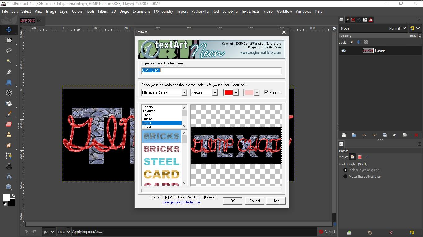

Creativity Text Art.
Dragonflys plugins seem to work as well.But you have to manually change colors as Gimp does not understand Photo shops Color panel.
You just need to google free PS filters or free 8bf's and you'll find many to try. :)

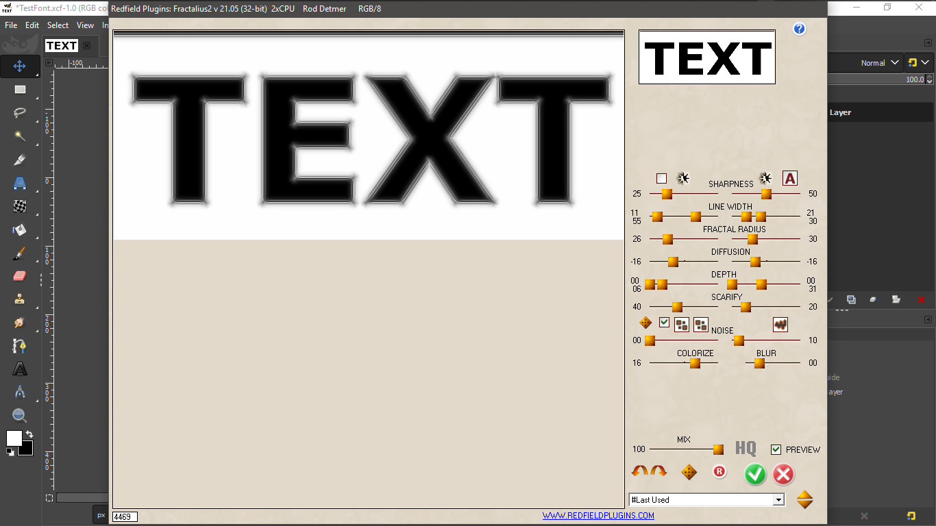

Redfields (some work) Fractalious does.
Although GMIC's filter Artistic>Rodilious filter does the same thing. :)
