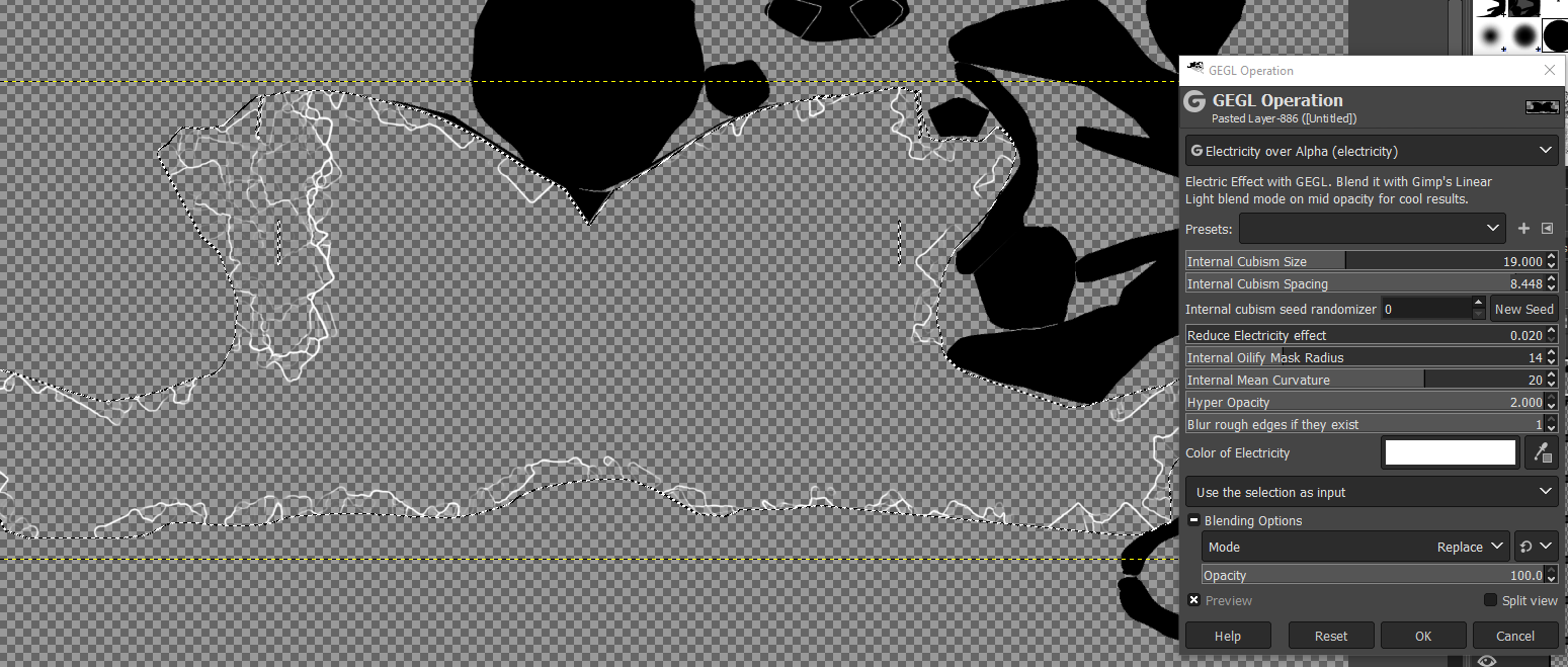

Is there a way I can get the effect to work on larger 'selections'? When I try it just does the top left corner?
Is there something I'm doing wrong?
Select "Layer to Image Size" for your canvas then apply Electricity again. The yellow dots selection is present in your image.
