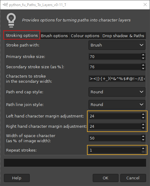

Start up Gimp, select a brush from the brushes tool dock and open the file containing the custom paths.
Call up the plug-in dialog:
Filters>>Custom Fonts>>Constructing Tools>>Custom Fonts Paths to Layers v.0.11 Tabbed
This tab remains almost unchanged; the highlighted values show the changes to the defaults used in previous versions.
Although the filter is primally intended for use with a brush it can also use the line tool to stroke the paths (first option on this tab). This can be useful if you want to create a version of a custom font in a different weight; this can be used as a base for decorating with other custom font tools.

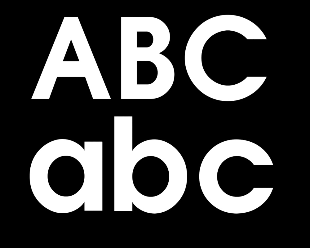

Use the filter setting the 'Stroke path with' option to line and a 'Primary stroke size' of 20. Press 'Ok'.
This creates a set of characters in a thinner style which can be used with other custom font filters.

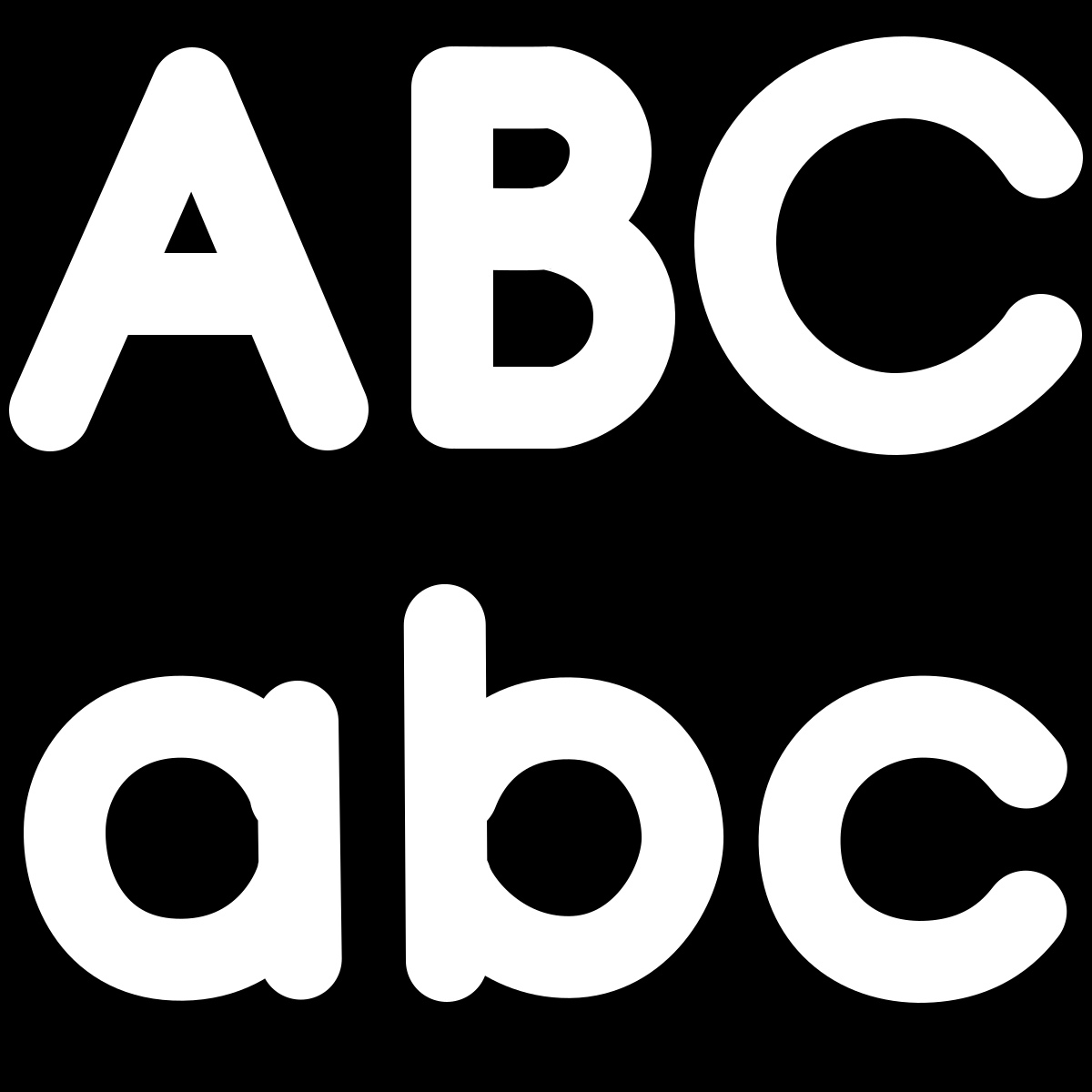

 Post subject: Re: Custom Font Paths to Layers version 0.11 Tabbed
PostPosted: Sun May 28, 2023 3:36 pm  (#3)
Posts: 2937

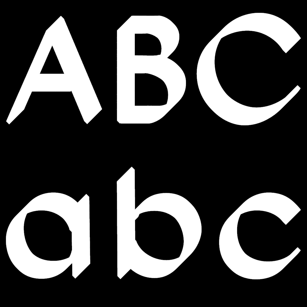

The line join and end caps also have different options which can be set to modify the style.
Using square end caps and bevel for the line joins (although small manual adjustments to some characters may need to be made) to modify the whitebase style.
And below using the mitre line join style with square end caps:

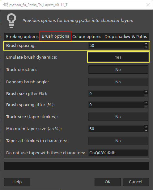

Tab 2 Brush Options:

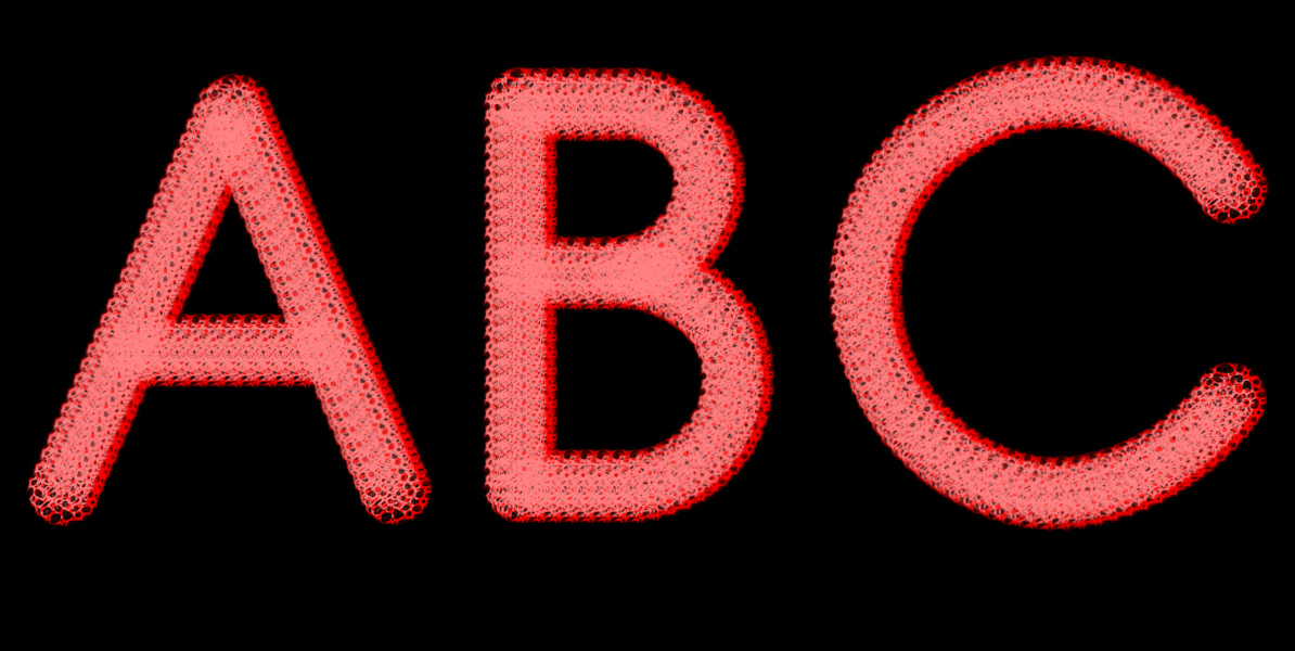

The Brush spacing option used to live on the first tab and the ‘Emulate brush dynamics’ option has a new default option of ‘Yes’.

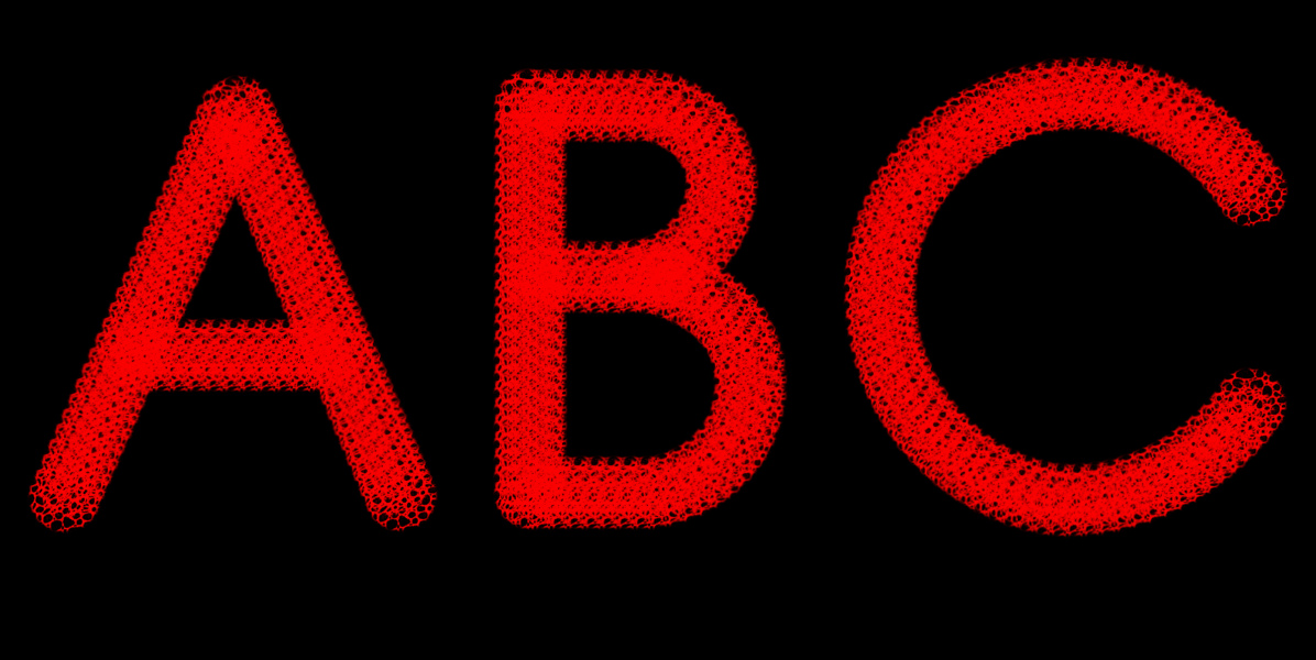

Choose a greyscale brush (they usually look black or grey in the brushes dialog) to apply colour and texture to custom paths. The example below uses a cell style brush with the default settings. Select your foreground colour in Gimp.
Open the custom font paths file.
Call up the plug-in and make sure that you are going to stroke the path with the brush tool. Set the 'primary stroke size' to 70 on the 1st tab and reduce the 'brush spacing' to about 10 on this tab. Hit 'Ok'.
My results:

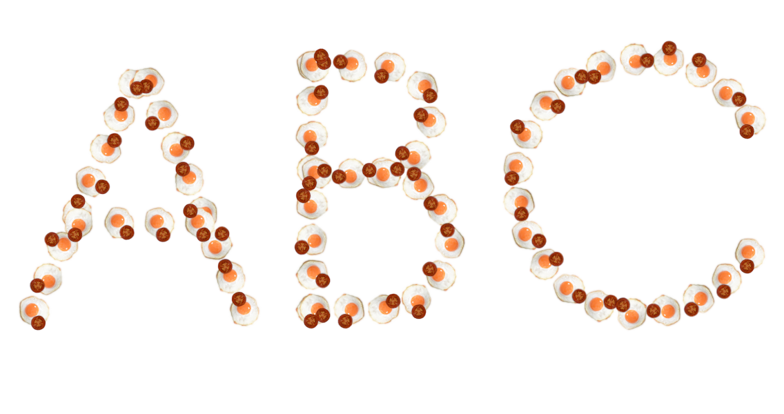

You can use an animated/pipe brush to paint objects along a custom path character with the appropriate spacing. The breakfast dish example below uses the random rotation option to add an element of variety to the characters. You will need to set the 'Brush spacing' to a larger value.
My fried egg brush:
You can add other objects by changing the brush (I used my tomatoes brush). Use Normal mode from the mode options on the Colour options tab.

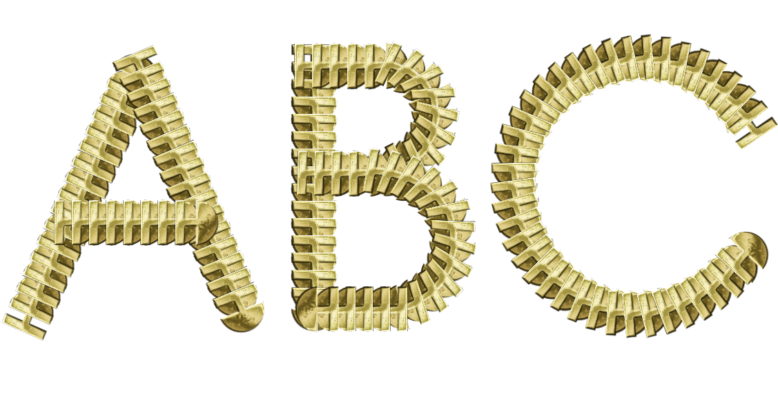

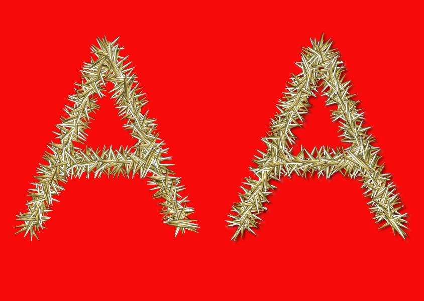

The 'Track direction' option works well - with appropriate spacing - for certain brushes.
This option can also produce some interesting results with abstract/shaped brushes. Gold is a current theme!

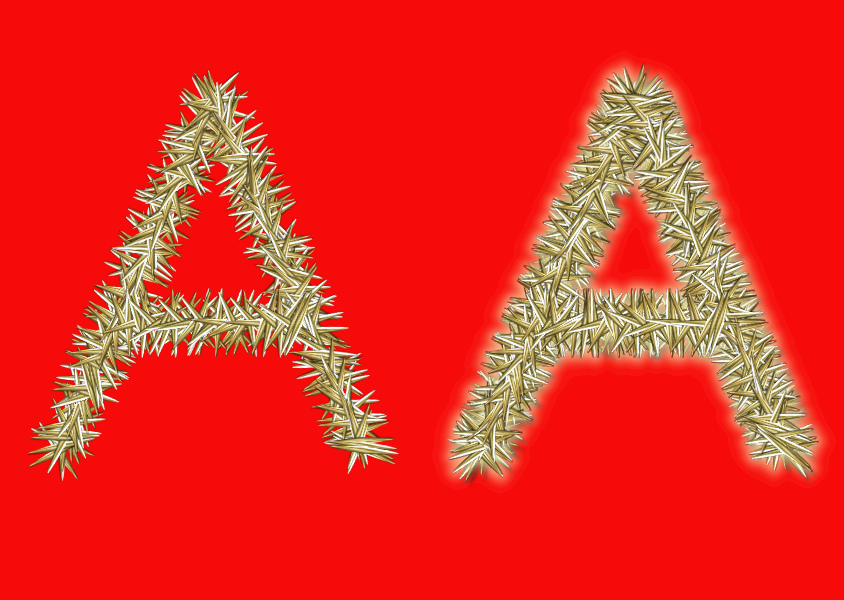

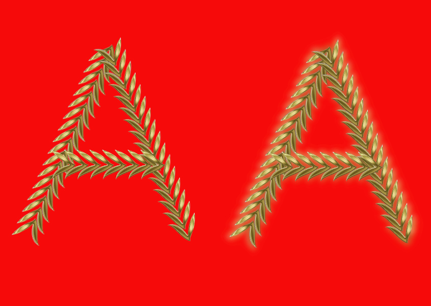

The example below repeats the same brush with the default colour settings (i.e. colour not applied). Use this with a suitable mode such as Grainmerge or Overlay.
In the next example 'Apply colour' has been used; the 'Brush colour option' has been left as 'Use foreground colour' and a shade of red has been used with Grainmerge mode. A reduced opacity value has also been used to add a subtle change of tone.
'Apply colour' also allows you to apply a coloured gradient (linear) to existing characters: E-W used here with a Green-Red FG to BG RGB gradient. Choose a gradient from the gradients dock in Gimp.

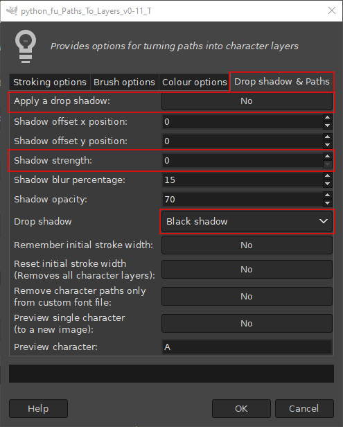

Tab 4 Drop Shadow & Paths:
The new options are again highlighted in red.

And finally a quick review of the remaining options on the last tab:
You can remove the custom paths (used to create the characters from the file) if required; just make sure that you do this as part of the last use of the plug-in with the custom paths.
You can also use the preview option to see the effects of the plug-in on a single character (creates a new image to do this).
The ‘Remember initial stroke width’ option can be used if you want to use the filter to centre a number of strokes with different widths on each character. The example below (from version 0.06) illustrates a character without and with this option in line stroking mode.
