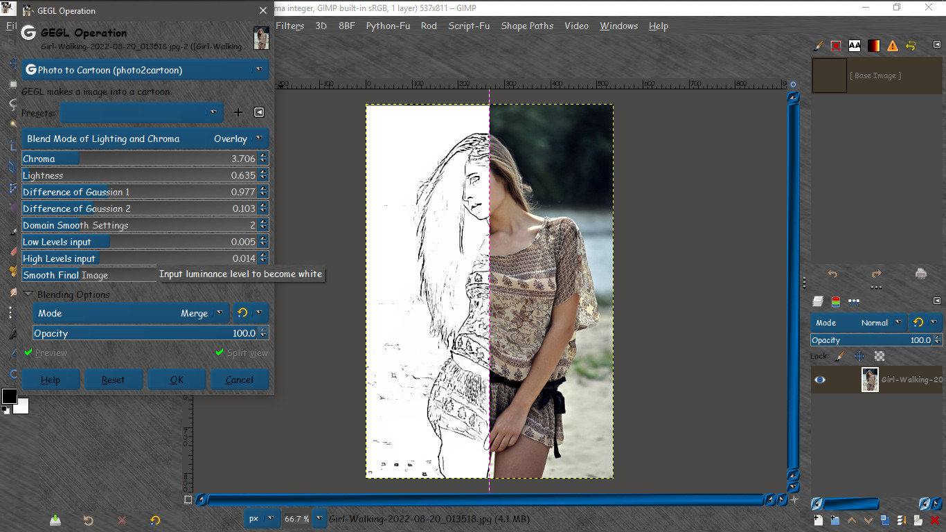

Cli345 made most the graph I just ported as a native GEGL filter.
https://github.com/LinuxBeaver/GEGL-Photo-to-Cartoon-
Remember this goes in /gegl-0.4/plug-ins. Not Gimp's normal plugin folder. (tons of people are making this mistake). This filter has internal blend modes. HardLight, Multiply and an option for Color Removal.
Cli345's other filter I ported is also here. (GEGL Pencil Sketch)
viewtopic.php?f=9&t=19928&hilit=pencil
Link to Cli345's original graph that this filter is mostly based on.
viewtopic.php?f=10&t=19463&start=20#p266181

The version on my computer does not have overlay. it says "remove color" This is because the version I uploaded to Github was when I tested the overlay blend mode and removed it because it was 95% like hardlight. I will be pushing a cosmetic update that replaces overlay with remove color mode. This will have no feature changes.
I may even make it where gegl:pencil and this are one filter. (But that would confuse novices) as I would have to add a gaussian blur and one other thing for pencil mode.

The overlay blend mode now works and does an actual gegl:overlay but it has a extra setting called srgb=true to make it distinct as possible from gegl:hardlight. NOTE This filter may trigger an error and force you to navigate to
config/GIMP/2.10/filters/GimpGegl-gegl-photo2cartoon-config.settings
and delete GimpGegl-gegl-photo2cartoon-config.settings. This apparently is a consequence of updating a filter with an enum list.
grrrr.......

I removed the pencil sketch ability as it is found in Gegl:pencil and gegl:pencil goes faster and has an additional blur option. I am thinking about giving pencil a white color overlay option but I am lazy. I could have made pencil and phototocartoon one filter but phototocartoon contains literally five domain smooths and that slows things down a lot.
