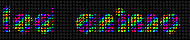

Turn this image Image
Into the below animation
or something like this where content is wider than LED panel (image size).
Instructions:
1. Have a layer of your art/text that you'd like to animate as LED animation (as example above I used 80x40 image because each LED bulb will be 20x20 so it'll be quite large). Note: Layer can be wider than image size to animate more than just viewable content at once.
2. Run plug-in from /Python-fu/LED Animation...
3. It'll create a new image containing elements to animate with and another image containing animation frames (animation).
4. Resize/Scale down the image to decent size to animate with as the raw result is quite large (20x20 per pixel from original).
5. Save as animated gif and you're good.
6. That's it...Enjoy.

This version allows you to enter a percentage (odds to have broken LEDs).
code below:

Hi Tim,
When you said it gets quite large you weren't kidding! In the end I went for a small image size about what you suggested and scaled the animation image down a lot using interpolation none for speed.
My first try went a bit wrong so I think other requirements are:
The layer of art/text to be animated should be:
The active layer.
The top layer in the image.
The same height as the image.
All other layers will be the animation background.
It's best if the background is all black.

 Post subject: Re: LED-Animation Plug-in
PostPosted: Fri Mar 31, 2023 5:42 am  (#6)
Joined: May 24, 2021
Posts: 859
teapot wrote:
Hi Tim,
The active layer.
The attachment santa.gif is no longer available
@teapot, you were not kidding too... :mrgreen:
I did not expect that huge size from a 250x100 px original image to become a 10 GB in GIMP! :huh
Thanks for the tips @teapot > The same height as the image., :bigthup
I confirm, same height or you will have 2 lines which was my first try...
@Tim, that's a very nice plugin, I love the effect :clap :tyspin
Maybe can you give us the possibility to chose the maximum number of frames as an option?
Patrice
PostPosted: Fri Mar 31, 2023 7:53 am  (#7)
Posts: 4469
The problem is each frame is one pixel movement....so an option to skip frames might not work out smoothly as the width might not divide evenly...
Let me know how you want to create frames if numbers don't divide evenly and I'll add it...

Excellent marquee animation Tran. :)
