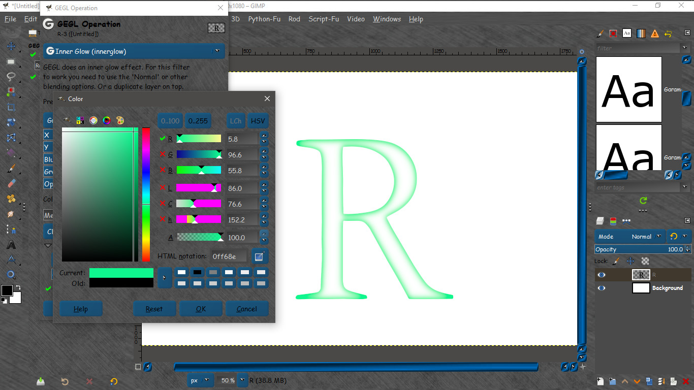

This is black text with the inner glow features. I am quite pleased with this filter. :bigthup

My question is, why does it change the text color? I just want to create the inner glow on the text without changing the text color.

Your text is probably too small or the blur radius is too high.

This is what I mean. The text change to white in all the colors I use for the text.

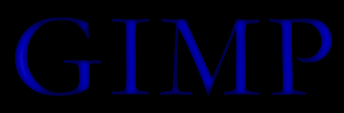

I will like to see this result:

You are suppose to use blend modes or a layer above. I did this intentionally so inner glow could blend with different modes and be non-destructive removable. The effect you used does the same thing but unlike GEGL, script fu can create new layers in Gimp.

If I did not do this the inner glow would not be able to blend as seen here.
