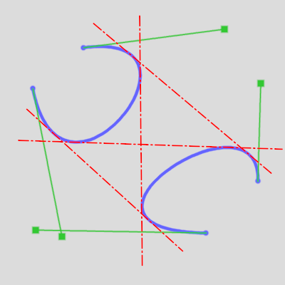

I think the problem is even a bit ill-defined. SaulGoode's question is about single Bezier splines, and we usually consider paths... But even then two splines can have 4 tangents:
And even with the condition that they have a common anchor, 1) there are obvious cases with no tangents, and 2) there are cases with two tangents.

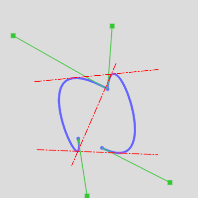

Edit: there are even cases with three tangents:
