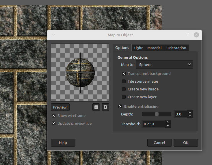

Does anyone know of a Shape 3D plugin or Script for GIMP? I know that G'MIC has the capability of making an image 3D, but is there anything else that can do it? The photo attached is from the program paint.net. Is there a plugin or script in GIMP besides GMIC that can create 3D images similar to how the Shape 3D plugin does in paint.net?

No plugin needed. Filters > Map > Map Object.
