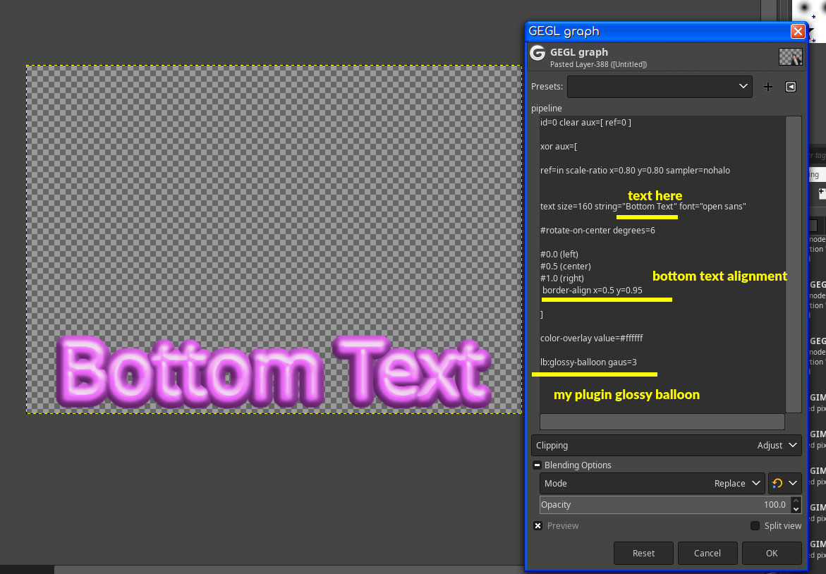

Using the graph of this filter I found a way to align GEGL rendered text (using gegl:text and pango-markup)
This could pave the way to a GEGL only text engine.
0.0 is left
0.5 is center
1.0 is right
x is horizontal
y is vertical
Try these commands in Gimp's GEGL Graph filter, requires an alpha channel.
There are two reasons this text thing cannot be made into a filter
gegl:text cannot space text and gegl:pango-markup can only space text using textual syntax (not a GUI slider)
GEGL cannot display the system's fonts (or any fonts) in a drop down list.
If Gimp's team fixes this we could have a new text tool

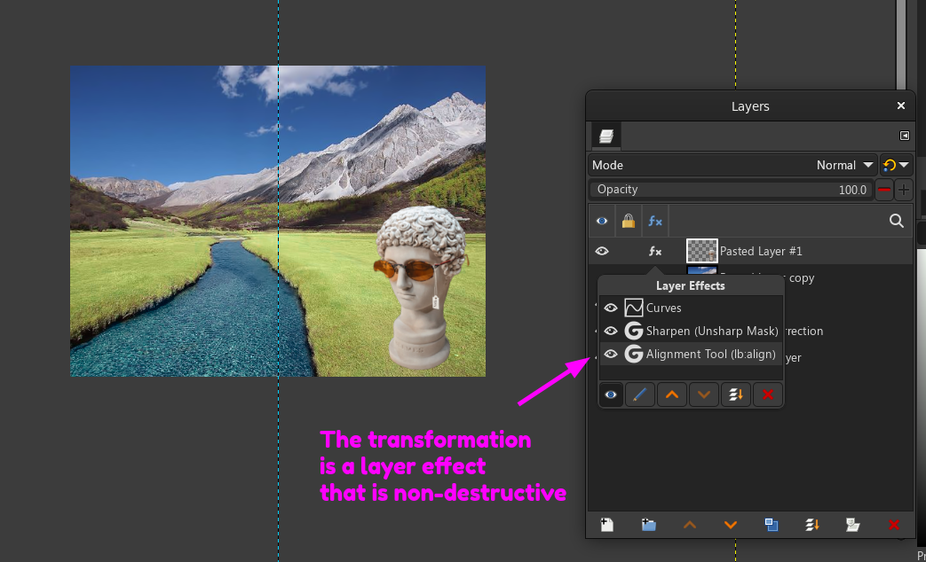

Non-destructive basic transformations in GIMP 2.99.19
As we all know GIMP 2.99.19 does not allow non-destructive gradients and non-destructive transformations. So I modified an existing plugin of mine to do that in a hacky way. Align tool is going to update soon with the ability to work like a scale and rotate tool in GIMP 2.99.19. Allowing basic non-destructive transformations

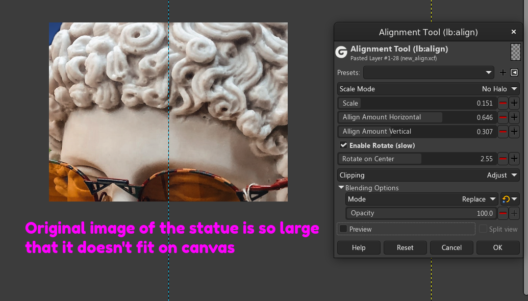

This image of the statue is so large that only a small part of it fits on the canvas.

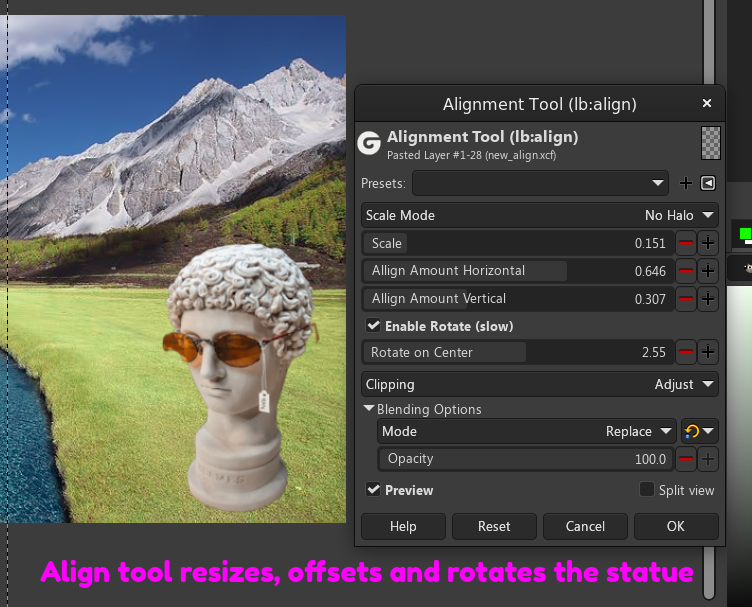

Align tool with its update to allow non-full size images and rotations applies basic scale, offset and resize abilities
Now the non-destructive transformation is a layer effect
