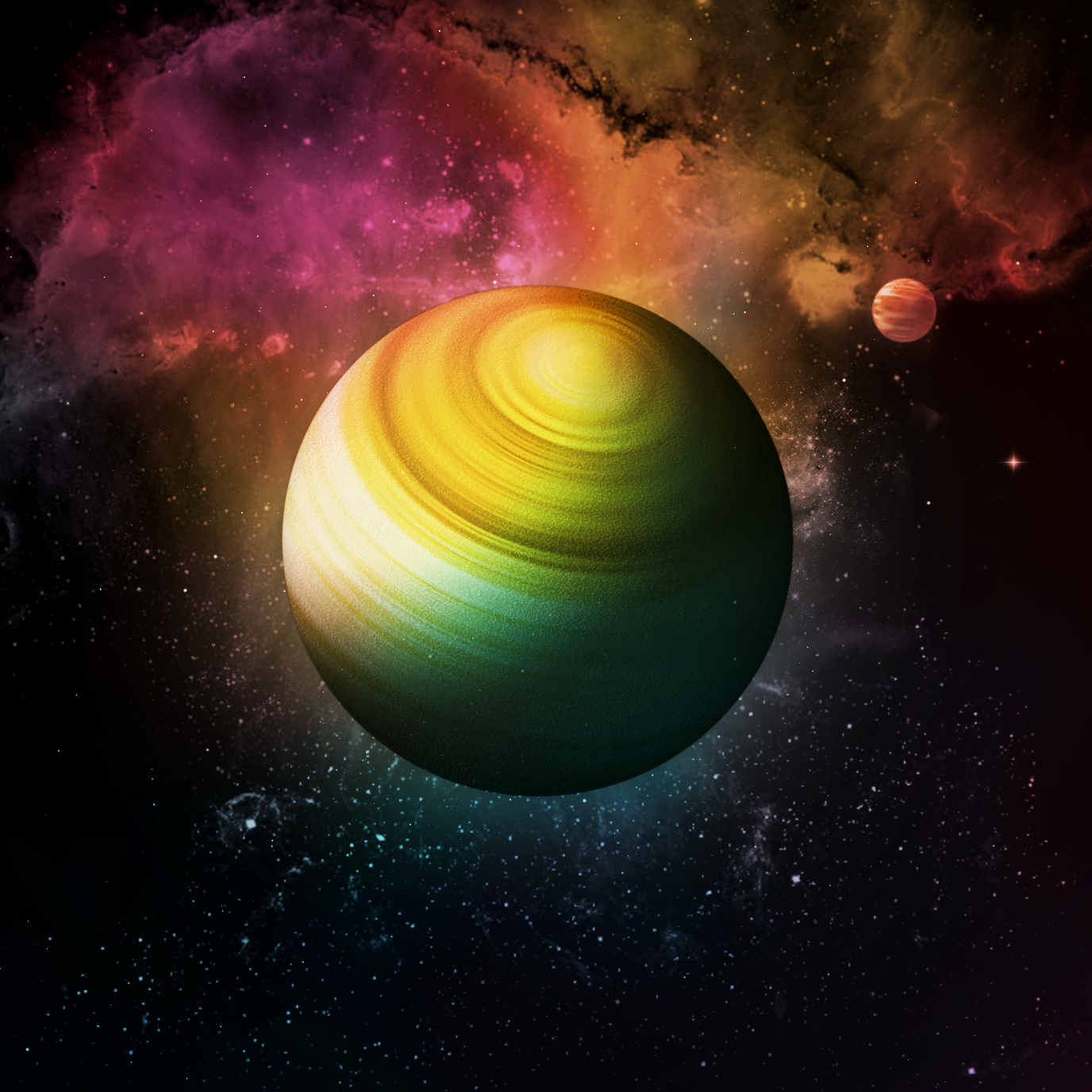

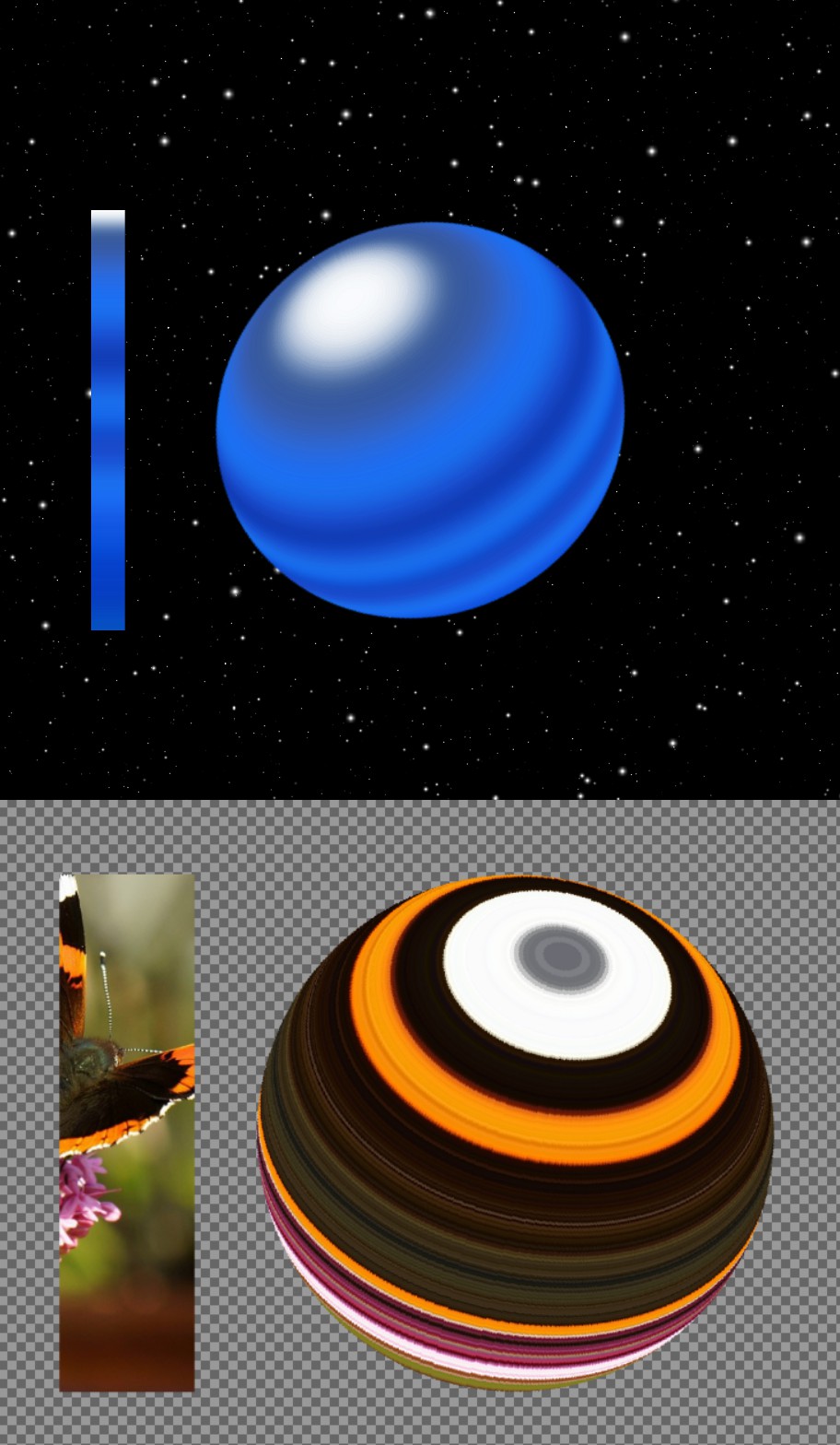

As an alternative to your script.
1) Select an area of 1pixel wide x any_height.
2) Copy that into clipboard.
3) Open a new image and fill this layer with the copied content (by dragging and dropping the clipboard from Pattern's window).
4) Map Object-> Sphere (what's nice if you get some lighting and preview of whatever rotation you're doing.
And if you select area of 1 any_width x 1 pixel height.
you'll get something like this

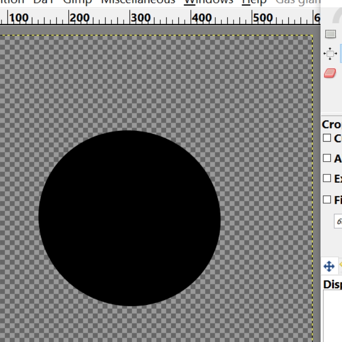

Unfortunately, there must be an issue with copying and pasting an image into GIMP. I did that with an image I wanted to use, removed the alpha channel, ran the script with default settings, and it just made a solid black circle. :?
If after copy/paste and removal of alpha channel the extreme vertical left hand column of pixels on the image the script is to run on is black, then you would get the result below
Am trying other options but other than above have not been able to replicate your problem
