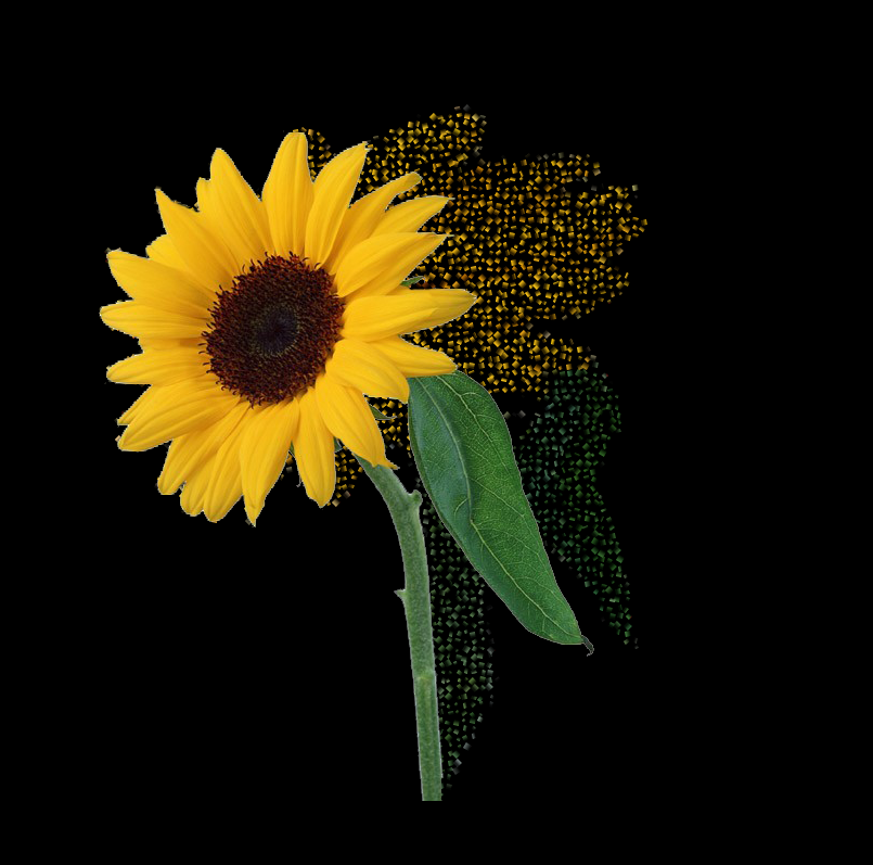

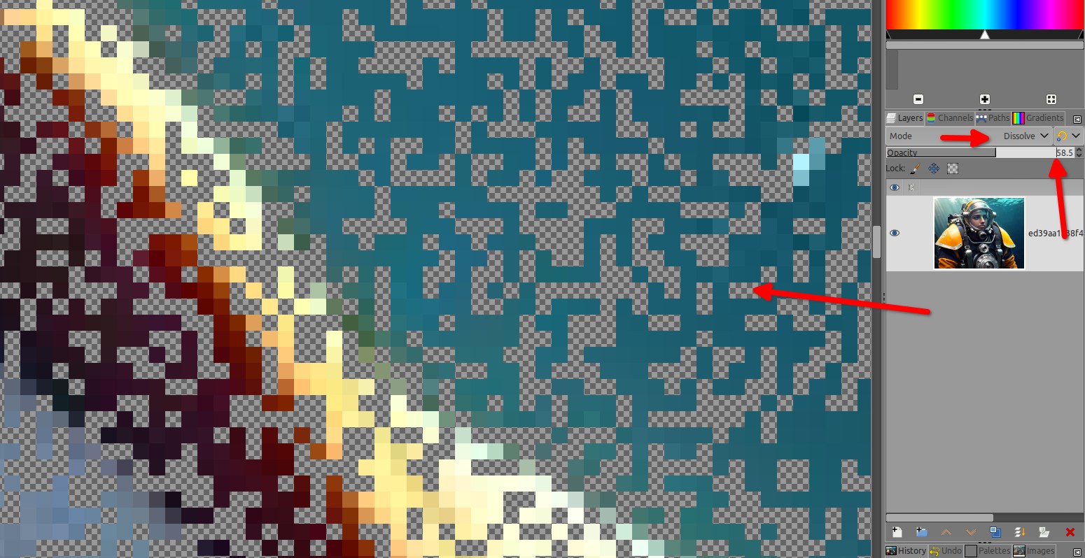

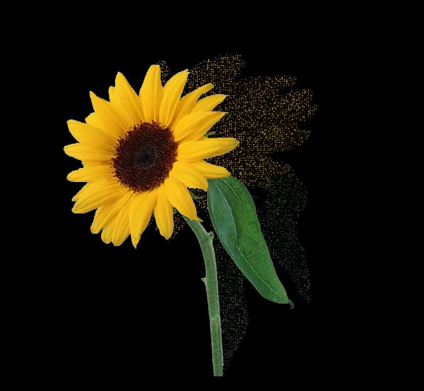

Layer or brush (not both) in Dissolve mode, it is the opacity slider which will control the more or less particle/dispersion effect > 100% opacity = 0 particle/not dissolved.
With a black brush with reduced opacity (or it will just work like a normal brush)
Or with the layer mode dissolved over a white layer
Good to know: The remaining particle are 100% opaque even if opacity is at 20%, as in this very case (the dissolve mode) the opacity slider will not affect the transparency in the usual way but in a dissolved way.

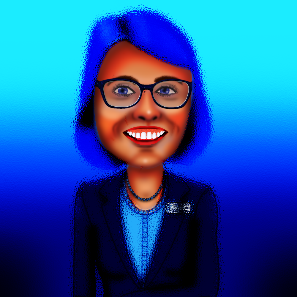

I have an old cubism. py file to get this result. Not completely satisfied yet.
The 2nd photo is with GEGL. cubism

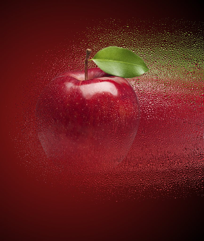

Now a little more time.
I did this in G'mic > deformations > breaks. Set type to relief.

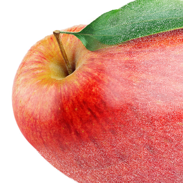

Very nice effect with G'MIC Jappaloe63 :clap :coolthup
Just quick play ;)
