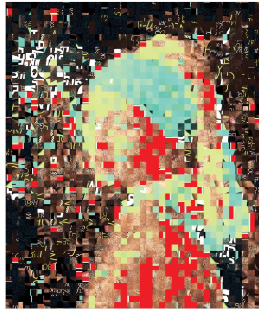

PostPosted: Tue Dec 03, 2024 1:16 pm  (#1)
Posts: 4469
tile collage where I take tiles from an image and try to assemble another image like this?
I might have shared it in gimplearn.net but I don't remember for sure.

Tin, I don't know if you are looking for it.
fix_collage Tile.zip [1.32 KiB]
Downloaded 31 times
 Post subject: Re: Does anyone remember me sharing a Plug-in that does this
PostPosted: Tue Dec 03, 2024 2:33 pm  (#3)
Posts: 14043
I was able to find this .py file named "tile_match".
Not sure if this is the one?
PostPosted: Tue Dec 03, 2024 2:38 pm  (#4)
Posts: 14037
Yes, this one can be Wallace. I have it too.
PostPosted: Tue Dec 03, 2024 3:50 pm  (#6)
Posts: 4469
Thanks! I was impatient so I wrote a different version on my pc now. hehe
