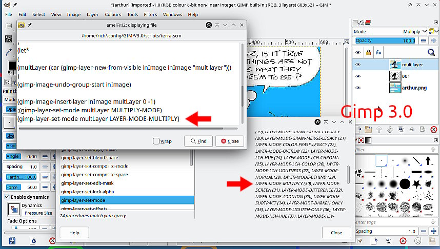

It could be that the Mint Gimp 2.10 does not have the compatibility switch enabled.
There is one parameter that uses the old syntax.
Vary rarely (so-far for me) a script-fu is easy to edit for Gimp 3.0 - this is one. A single parameter to change, and it works with both Gimp 2.10 and Gimp 3.0
script attached, works here but as usual no guarantees.
