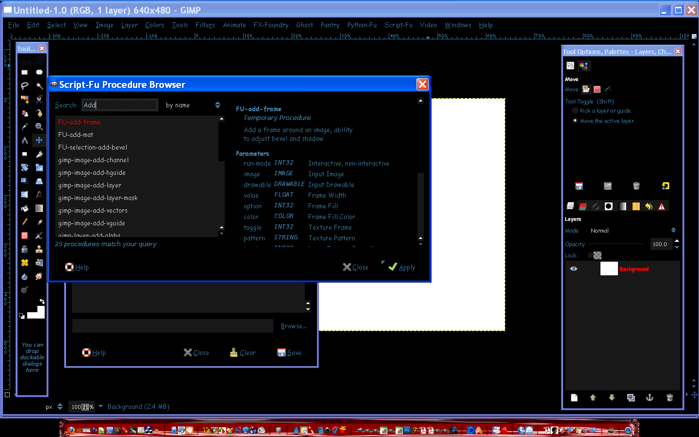

Rod may be a quicker way anyway Filters/Script-Fu/ Script-fu Console
there just click the Browse button in the bottom right;
that open the Procedure Browser that will show all procedures including here all script installed
Only search may be a bit painful because as far i know there is no way to distinguish gimp-built-in procedures , extra plugins and extra scripts
And to make search harder the name used is that in the script or plugin registered block of the script (or plugin or tool )
So as example the gaussian blur filter would be called plug-in-gauss Liquid resize gimp-lqr and so on
Anyway luckily you may even search for Author , for Date, and for Type , and that help a bit

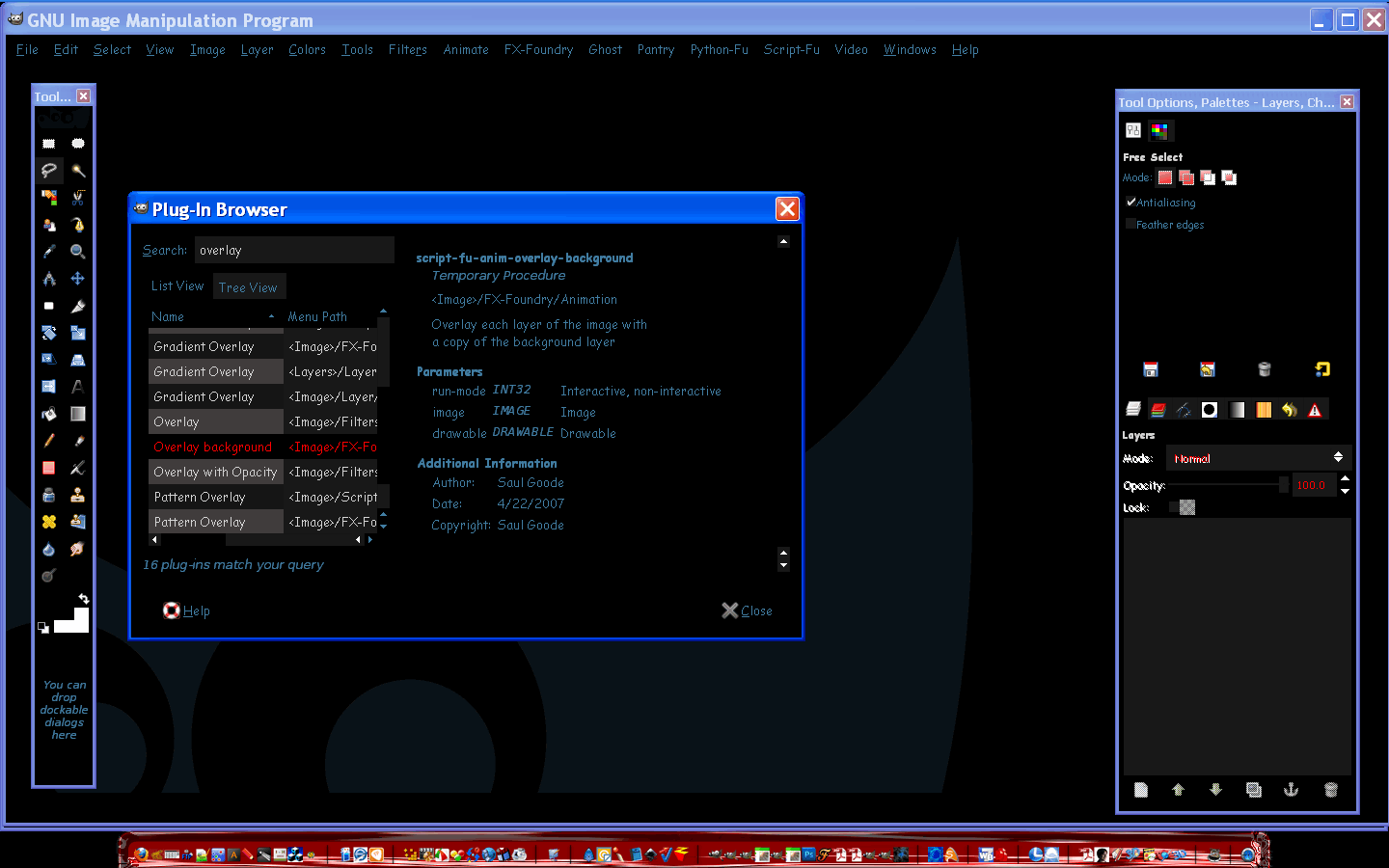

The plug-in browser is a very good search engine for scripts and plug-ins. Scripts are plug-ins in their own way. I can find any plug-in/script I have in there.
There are two different views in the Plug-in browser: Tree and list view and all of the ones a user has are listed in it. The dialog can be stretched way out to accommodate everything that is in it. Ones that come with GIMP and the ones the user adds are all there. You just need a word from any one of them to find it.
List view for Gaussian blur.
Tree view for Gaussian blur.

RobA wrote:
Missing something.... The plugin browser does show all the scripts, too?
-Rob A>
Ahh never mind i did a search for my mats and frames script and it returned nothing so i thought it didnt find scripts (SCM)
As you can see it does find scripts with the script name.I wonder why it can not find mats and frames?
That is what the script is named - should it not be listed as
<image>/Script-Fu/Decor/Mat and
<image>/Script-Fu/Decor/Frames
In the plugin browser?

I tried the script console browse but it doesn't really give you a menu location.
Plugin Browser does but it seems some just do not get loaded or something.
In the SCRIPT procedure browser (a bit different from what used by O ,see my first message)you may search for "type"
try "Decor "
or if you remember Author name search for "Author"

There it is! :lol - doesn't help me to find it in the menus though.
Seems like it would just be a lot easier to have its own dedicated script browser (just for SCM's) :)
