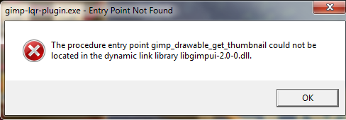

For what it's worth, below's the error that i get during launch. At least it's only one pop up error. lol

All of Partha's plugins for 2.7x worked PC except LqR. I'm thinking it has to do with the dynamic library. Thanks to MareroQ (which he credit's RobA), I can run both version 2.6 32-bit and 2.8 64-bit simultaneously if I need to have LqR (only occasionally use it now). PSPI works, and so does Mathmap so happy camper am I. It will be weeks if not months before I get use to all the changes and also port all the scripts and such like I want them, but am glad that multi-window (don't want to go single window) option works in 2.8; in fact, it was the default for me so I didn't have to do anything. lol
