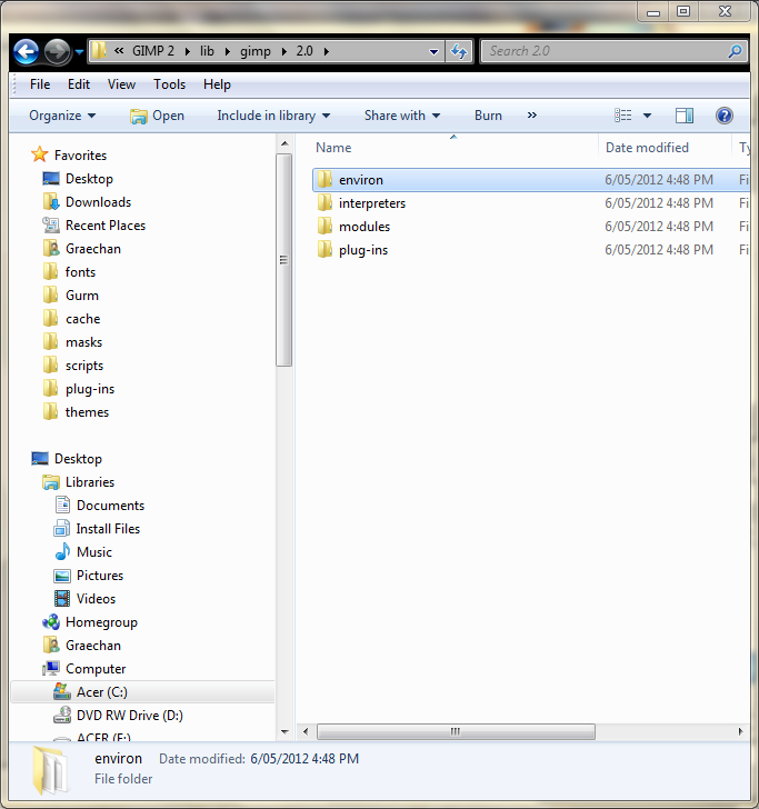

He tested it on Gimp-2.6 but i tested it in Gimp-2.8 and it does work.
Make sure and read the README file included in the zip download.(it gives you install instructions)
With the correct formula you could make some pretty cool knotwork with this one. :)

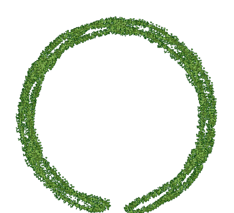

I did this image with the last formula i tried.
Then did a stroke path then a theirs>pan to Bow, and then a alpha to selection on the pan bow layer and select to path.Then i stroked the path with the vine brush.
Then i did another alpha to selection and stroked with a dark green to bring it out more. :)

PostPosted: Fri May 18, 2012 9:19 pm  (#14)
Could someone who has this working show where they installed the 2 files please, as I think I did not understand the readme file correctly.
 Post subject: Re: Bytes and Pixels Vector Path plugin
PostPosted: Fri May 18, 2012 9:27 pm  (#15)
Joined: Jan 20, 2012
Posts: 583
Userpath/plugins
PostPosted: Fri May 18, 2012 9:47 pm  (#16)
I open a blank image and select vector path then nothing happens, no menu comes up
PostPosted: Fri May 18, 2012 9:48 pm  (#17)
Posts: 16168
Parthas Build.
Place the b&p_vector_path_1.py file in the plugins folder and the other formula_viewer.pyw file needs to go in
gimp-2.8\python
and
gimp-2.8\lib\gimp\2.0\python Graechan. :)
I am not sure about any other compiled src. If the compile includes python it should be the same.
PostPosted: Fri May 18, 2012 10:19 pm  (#18)
I placed the formula viewer here C:\Program Files\GIMP 2\Python and vector path here C:\Users\Graechan\.gimp-2.8\plug-ins
still no go
PostPosted: Fri May 18, 2012 10:20 pm  (#19)
Posts: 16168
Try and place it also in the gimp 2\lib\gimp\2.0\python file Graechan.
I had to place it in both locations.
PostPosted: Fri May 18, 2012 10:38 pm  (#20)
This is my C:\Program Files\GIMP 2\lib\gimp\2.0 folder and it does not hav a python folder
should I create one
