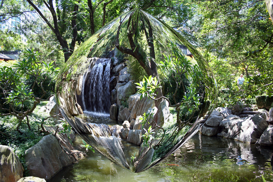

Ok to get started
Rounded Rhombus
save as .mmc, NOT as .mm
# by PhotoComix
filter map_sphere (image in,
                   float alpha: 0-6.2831853 (3.4), float beta: 0-6.2831853 (4.2),
                   float gamma: 0-6.2831853 (5.2), color background)
    rd=0.9*min(X,Y);
    if r>rd then
        background
    else
        sa=sin(alpha);
        sb=sin(beta);
        ca=cos(alpha);
        cb=cos(beta);
        theta=a;
        phi=acos(r/rd);
        x0=cos(theta)*cos(phi);
        y0=sin(theta)*cos(phi);
        z0=sin(phi);
        x1=ca*x0+sa*y0;
        z1=-sa*-sb*x0+ca*-sb*y0+cb*z0;
        if z1 >= 0 || 1 then
            y1=cb*-sa*x0+cb*ca*y0+sb*z0
        else
            z1=z1-2*cb*z0;
            y1=cb*-sa*x0+cb*ca*y0-sb*z0
        end;
        theta1=atan(-x1/y1)+(if y1>0 then pi/2 else 3*pi/2 end);
        phi1=asin(z1);
        in(xy:[((theta1*2+gamma)%(2*pi)-pi)/pi*X,-phi1/(pi/2)*Y])
    end
end
filter rel2ellv3(image in)
xprime=x/sqrt(1-4*(y/H)*(y/H));
yprime=y/sqrt(1-4*(x/W)*(x/W));
in(xy:[xprime,yprime])
end
filter __composer_filter__ (image map_sphere_in, float map_sphere_alpha : 0.000000 - 6.283185 (3.400000), float map_sphere_beta : 0.000000 - 6.283185 (4.200000), float map_sphere_gamma : 0.000000 - 6.283185 (5.200000), color map_sphere_background)
    map_sphere_out = map_sphere(map_sphere_in, map_sphere_alpha, map_sphere_beta, map_sphere_gamma, map_sphere_background);
    rel2ellv3_out = rel2ellv3(map_sphere_out);
    rel2ellv3_out(xy)
end
Before/after...in only 1 image the Before is the BG (on the periphery ) the After is the object in the center
trying now a animated variation...

Also the Animated version seems working fine
Please note that Animated Sphere (used here ) use a very different type of mapping of Map Sphere (and of Distort Sphere ).. i prefer that from the animated version (That may used for still just setting the frames to 1. )
ooopss something unexpected the filter work fine but something wrong happened when i saved (the code not the image)
I try again now ...OK now seems fine
TIP use on images that could be tiled horizontally (as example equirectangular images ..or simply mirror first on the x axis )
