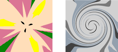

Here's two different coloured Fascinators as a backdrop..
Four fascinators chained to create the daisy, a bit of twirl and a recolour in Gimp for the storm..
Right enough playing, time to go drink some beer :clap
