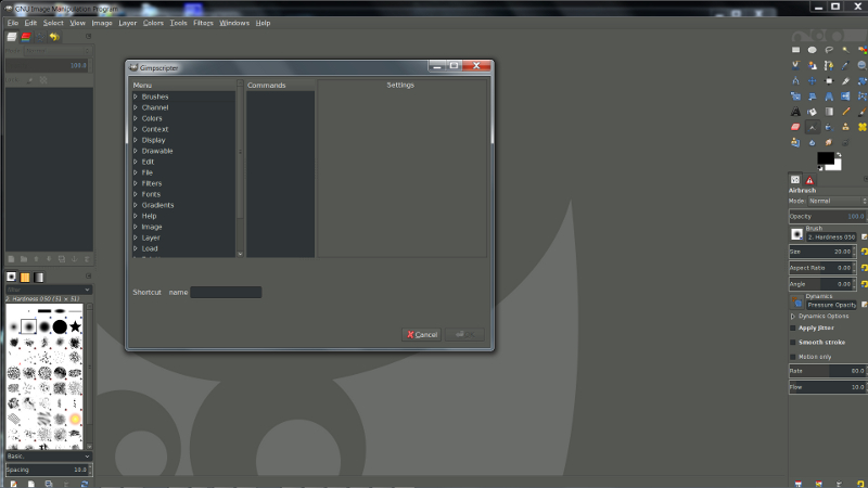

To install, do the following:
1. Copy the main plugin-gimpscripter.py to your plug-ins folder.
2. Copy the folder gimpscripter into the plug-ins folder.
That's it. It will be available under Filters -> Gimpscripter
Something like this:
File comment: Gimpscripter Window

partha wrote:
PC,
What issue are you having?
PS: I have not used it, just installed it.
@partha
could you check if for you works ?
just chose from the left panel 2 or 3 procedure to call sequentially and see if you can apply create and store a new shortcut
i get now problem in the very last step, for me OK does nothing at all

PhotoComix wrote:
partha wrote:
PC,
The attachment gimpscripter.jpg is no longer available
@partha
Here you go.
File comment: Scripter output
PS: Again, just playing and not really using it. :)
