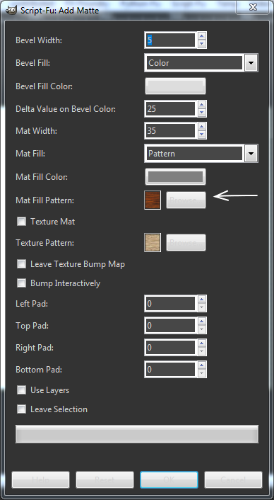

Quick mod added to allow user selectable patterns in both scripts
Now also modified to work up to 2.8.2 32bit and 64bit versions

I use Gimp 2.10.8 and i have a problem with : FU_edges_mats-and-frames.scn
Gimp say :
Message Frame with Bevel
Erreur lors de l’exécution de FU-add-frame :
Error: eval: unbound variable: NORMAL
and
Message Gimp
Plug-in 'Frame with Bevel' left image undo in
inconsistent state, closing open undo groups
Have you a tips for fix this problem ?
Regards

Try this one. No extensive testing but seems to work.

Yes !!!
It's work fine.
Thank you very much for your time about this problem.

Missed the line for the texture. Revised. Replace the previous version.
