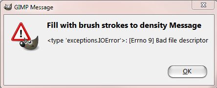

I can't get to work your density brush fill script, Ofnuts. Tried to run it in GIMP 2.6.11 and 2.8, with animated brushes and parametric ones, on single and multiple-layer images, with and without selection. The same error message
Is that something i'm not doing right or...?

Yes, Windows, but it's a Python script, must work no matter what, the dependency is the Python package, not OS. Just 2 GIMP Python scripts that I know of are specific to Linux environment and wouldn't work under Windows.
 Post subject: Re: Density brush fill (Ofnuts)
PostPosted: Wed Dec 05, 2012 3:01 am  (#10)
Try the new version I just uploaded. Actually there is a subtle difference in Windows in the way the "print" instructions I use for debugging are handled. In Linux they are ignored, but in Windows the script crashes if the cumulated output goes above some size (4K or 8K, I don't remember).

Thank you, Ofnuts. It works now.

The version I uploaded also works on Linux. It's more how things run under Windows. On Linux standard output (which get the printed stuff) is always available and goes somewhere (/dev/null, a minima). On Windows it won't be available for programs not started from a command prompt. I think that the Python runtime doesn't notice and when the output reaches some cumulated size it tries to flush its internal buffer to stdout and things don't go very well then. Now (that one was one of my first) I remove the print statements before making my scripts public.
