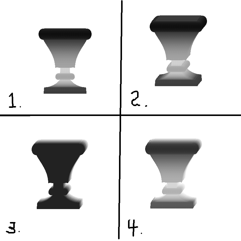

I use two images to make one image that appears to have height. I start out with #1 and copy to clipboard (Hard edges) Then use it as a brush to create #2 with no brush dynamics. Then I create #3 using a dynamic of size - color. When one (#2) object on its own layer is placed in front of (#3) object on its own layer set to screen mode it produces #4. It's a nice 3D type of height map.
If someone could wright a script to do that it would be nice. If it could include scaling it would be even better. But with scaling the edges tend to be pixelated so as to not made smooth edges which doesn't work.
