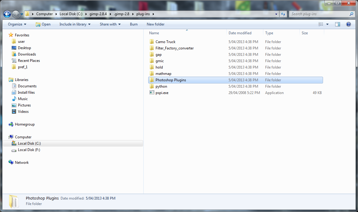

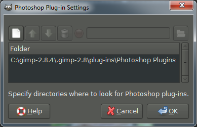

PostPosted: Fri Apr 05, 2013 1:31 am  (#16)
I don't know if this of any help.

It does not give problems if you install your photoshop folder and pspi in a particular way
Place your photoshop folder and pspi in your plugins folder
Do not point to the photoshop folder in preferences
Point to your photoshop folder here
Thanks Odin and Graechan.
Graechan i will give that a whirl. I always thought having folders in your gimp-2.8/plugins folder caused problems with linking. :) But i will give it a go.
