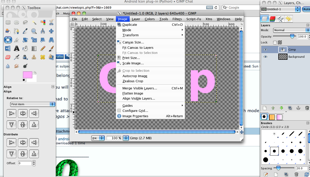

Interesting...I don't have 'filters' under 'image'
 Post subject: Re: Android Icon plug-in (Python)
PostPosted: Sun May 01, 2011 8:13 pm  (#8)
The term, <Image> refers to the menu in the image window.
A path, <Image> Filters > Whatever, <Image> refers to the Image.
