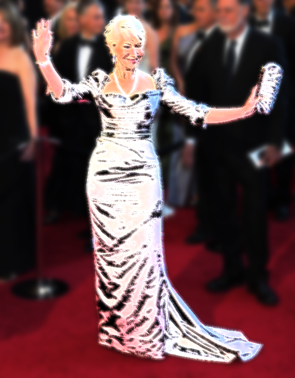

I have this image of the fabulous Helen Mirren....so I made a matte around her, blurred and darkened the people behind her and then ran the toon-inator script. Merged the layers and ran that Rodilius filter (numbers way down). it added a bit of glow to her. she has plenty of internal glow anyway.

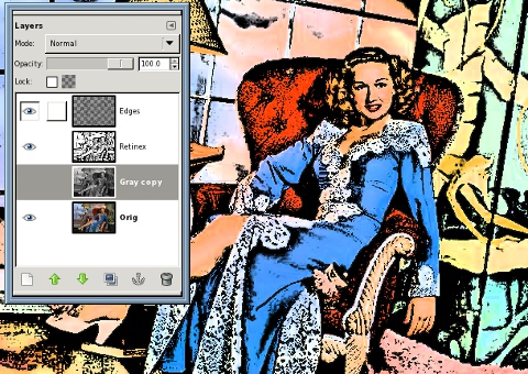

best cartoon script I have run across! Wondering if there are any hints to prepare a pic to be cartooned that can tweak the results either to be more or less colorful, or have more or less black lines?
 Post subject: Re: Toon-inator : a cartoon effect script
PostPosted: Tue Oct 04, 2011 5:11 am  (#14)
Joined: Apr 23, 2010
Posts: 1553
One of things I've noticed is that the amount of black is inversely proportional to the amount of saturation in the starting image. This can be effectively used by running the filter on a duplicate layer that has been desaturated to obtain more black shadows and lines, and then hiding/deleting the duplicated layer.

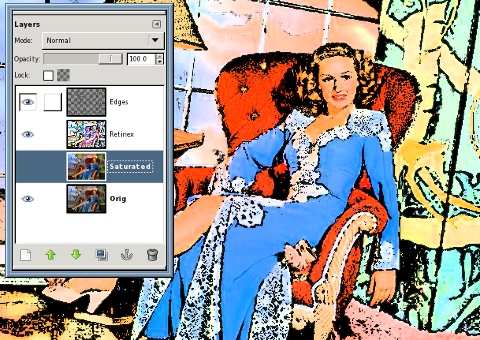

Or conversely, increase the saturation of the duplicate to reduce the amount of black.
