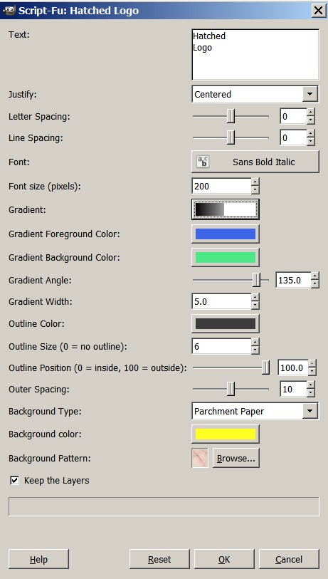

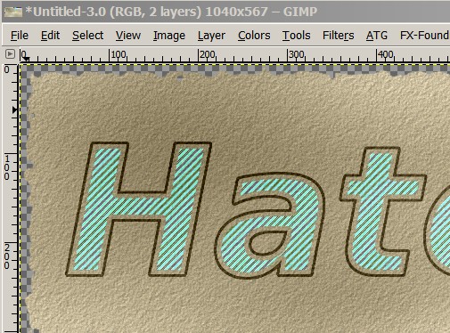

Graechan,Thank You for the script. Does the script require Gimp 2.8. I run Gimp 2.6.11. The script is located at ScriptFu/logos.
The script works in a fashion or am I just doing it wrong (not understand the inputs ). Here is the result of running the script. The colours do not make sense to me. Also my starting image was 640 x400 and the script output is 1040X567. Does it scale according to font size?

Yes I am aware of that. I expected the parchment paper b/g as that is the choice. The yellow is from a previous experiment with colours. ( I should not have left it there, my mistake). My problem really is with the colours generally. If you look at the outcome colours and the input colours, you will see that there is no resemblance to my colour choices in the input to the script. Also you will notice the different image size and the transparent area surrounding the parchment. The original document is white 600X400.

I found that too wooble, my color choices didn't correspond with the ones in the dialogue.

I think that only Gradient input is working the other two ( Gradient foreground color and Gradient background color ) dont change anything!

If you save the layers you will notice the the text-layer is set to GRAIN-MERGE, alter this to NORMAL and your colors will be OK
