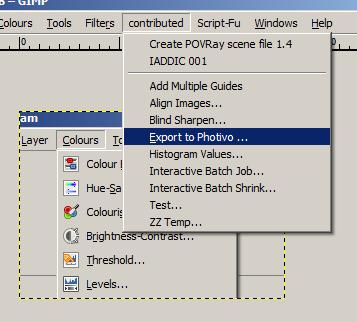

There was a question some time ago on one of the mailing lists about plug-ins having their own icons like the standard tools do:
But I don't recall there being any response to the question.
My solution to the problem is to keep add-ons in separate folders, then modify their menu registrations to put them in a separate menu:
Kevin
