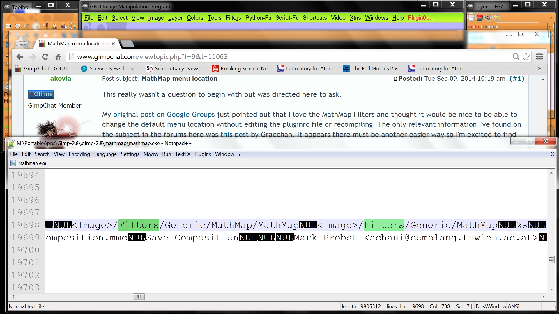

This really wasn't a question to begin with but was directed here to ask.
My original post on Google Groups just pointed out that I love the MathMap Filters and thought it would be nice to be able to change the default menu location without editing the pluginrc file or recompiling. The only relevant information I've found on the subject in the forums here was this post by Graechan. It appears there must be another easier way so I'm excited to find out what it is.
I went ahead and compiled my own version of MathMap with the menu location I wanted so I can avoid hand editing the pluginrc, which is what I used to do. There is nothing wrong with editing the pluginrc, but I prefer it in the code so I don't have to worry about using it in different versions of gimp, or worry about re-editing the pluginrc should I need to delete it for some reason.

akovia
in mathmap.exe you will find this line, editing this will change
where mathmap appears in gimp's menu, otherwise you have to
change gimp's pluginrc

Mikechat wrote:
akovia
Thanks Mike but I am already aware of both solutions and opted to change the source to compile my own version vs editing the pluginrc. If I understood Graechan's post correctly, he has a way to do it from within Gimp itself.
Graechan wrote:
To change the menu location is simple and easy to do from within Gimp
Gimp 2.8.16
Arch Linux - XFCE 4.12
Some of my work.
