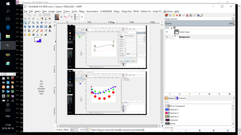

And here a picture for some explanations:
OK, try as follows:
1. download the *.zip en unzip it either in existing plugin directory, Gimp looks at, or an new one and inform Gimp where to look to.
2. start Gimp and open say a new window (empty or not)
3. the plugin should occur under a Tab in the main window under PKHG ;-) with name: Casteljau alemein ..
4. first try if it works and aftwards play with the parameters
In the upper image you see the handles of a Path and what the Plugin does with not changed parameters (maybe the number of points around 200 say).
The Brush is not yet active, though you can push it, help to activate it for the plugin is appreciated
If the handle- vectors are set (anti-)symmetric and a vertical then the painted points are symmetrical too, if not, the number of point on one end may be much more or so ... try :yes
Comments are welcome ;-)

Well that was fast. :)
All the points seem to work well. I set it to go from the left to the right dropping slightly at the end. Fun to play with for sure.
Thank you. :)

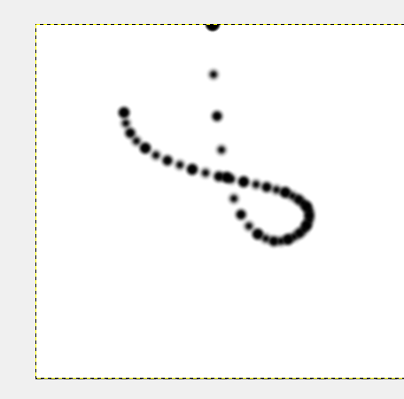

One part maybe interesting though, to use the Casteljau def ... with more than 4 points for higher order Bezier Curves ...; will try myself soon.
One thing in Gimp is, as it looks like, one can step in equal steps over a PATH ... (have built that too using only Gimp tools), this is NOT the case in this 'primitive' path filling method of the plugin I added in this thread.
What you may help me with is: how to activate the in the UI chosen brush for the plugin.
Read something that it is maybe (yet) impossible??? Context-problem???
EDIT:
Casteljau with longer input_list gave e.g. these points:

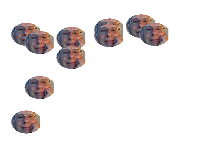

The plugin is now made with English names and using Clipboard as BRUSH :)
To add checks etc .. to be done ...
First quick test:

OK, will be done tomorrow ...
Hm, thinking about it, I should not delete the first version.
Reason: the first is suitable to play with 3rd order Bezier (with start- end- point and two vectors)
the last one is to examine to different orders of Bezier Curves ;-) and has a different UI
which is not optimal, could need help to make it clearer
