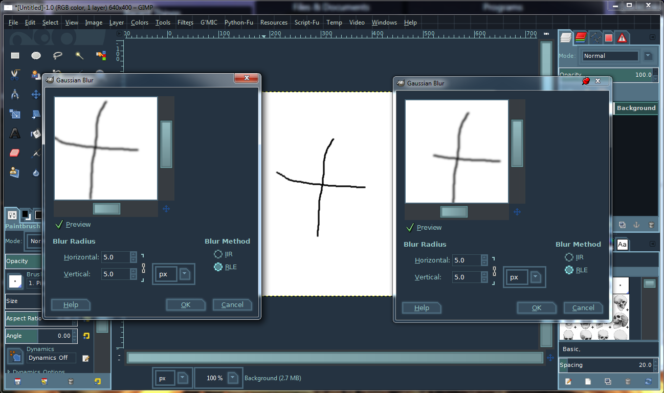

Why can't we interactively call a script-fu whilest in a script-fu I can call other plugins twice, why not script-fu.exe
The answer is in this thread..
viewtopic.php?f=9&t=2850#p36798
Basically, it's because you don't actually call a Script-Fu script directly, like a plug-in, you call the Script-Fu plugin, which runs the script interpretatively. The Script-Fu script can't then call another Script-Fu script interactively because the Script-Fu plug-in is already running your script interpretatively and there is no mechinism to spawn another instance, while passing the proper parameters/arguments to the new instance.

GnuTux I know what it says but scrip-fu.exe is just a plugin and i can call other plugins twice interactively
and it only says no in the src file, info below is from the script-fu-interface.c file, not sure what the intrface.c file relates to
gtk_table_set_col_spacings (GTK_TABLE (sf_interface->table), 6);
gtk_table_set_row_spacings (GTK_TABLE (sf_interface->table), 6);
gtk_box_pack_start (GTK_BOX (vbox), sf_interface->table, FALSE, FALSE, 0);
gtk_widget_show (sf_interface->table);
Well, it's not just any old plug-in. It's a scheme interpreter and the problem arises when attempting to call another instance from a script already running inside.
The interface to the interactive dialog can't be called from a script running in the scheme interpreter, because the interface code exists outside the interpreter.
