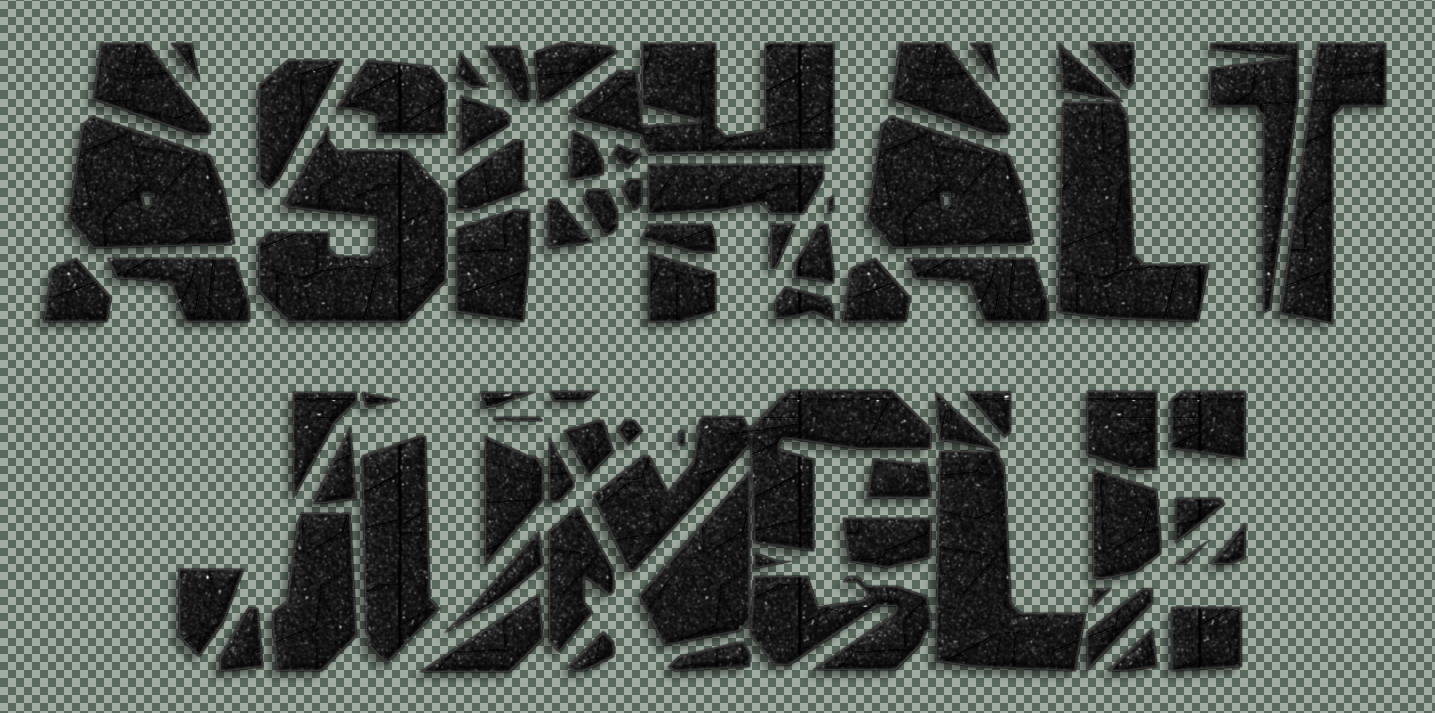

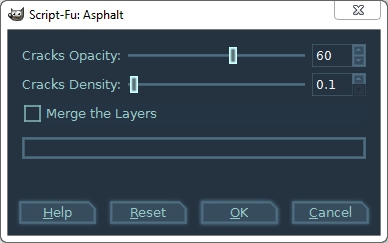

script uses Conbagui's method of creating asphalt located Here
Asphalt can create a pattern of Asphalt on drawable or within selection if one exists, requires the GMIC plugin to complete the pattern
Menu Location Script-Fu/Patterns

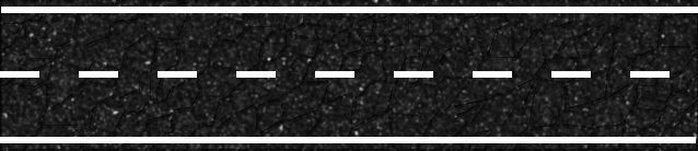

Used here to create a Road (opps forgot the road kill)
Asphalt.scm [8.82 KiB]
Downloaded 339 times
