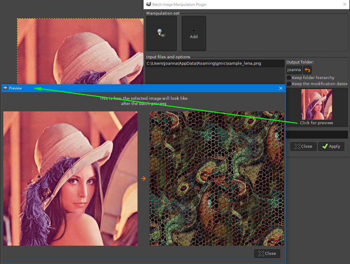

I've been using this for a long time.
Possible with a small caveat.
BIMP does not support xcf, so the result will be saved as "New from visible".
So it requires writing a simple plugin that will correctly manipulate layers (a small example in the appendix with built in gegl_command by Kevin Payne and Claude Lion) and use in BIMP: "Other Gimp procedure ..."
If you want to keep layers, there are other plugs for that (they process images opened in Gimp as layers).
Example GEGL Test.zip [1.43 KiB]
Downloaded 164 times
