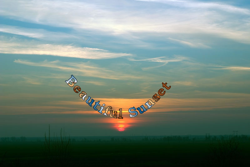

Great job everyone. :) The tutorials were very helpful in learning. Thanks!
Here are mine. :)
File comment: From Mahvin's tut

Oh, Liana, those are superb. Excellent work. Keep on gimping. You're gonna go far. :gimp
