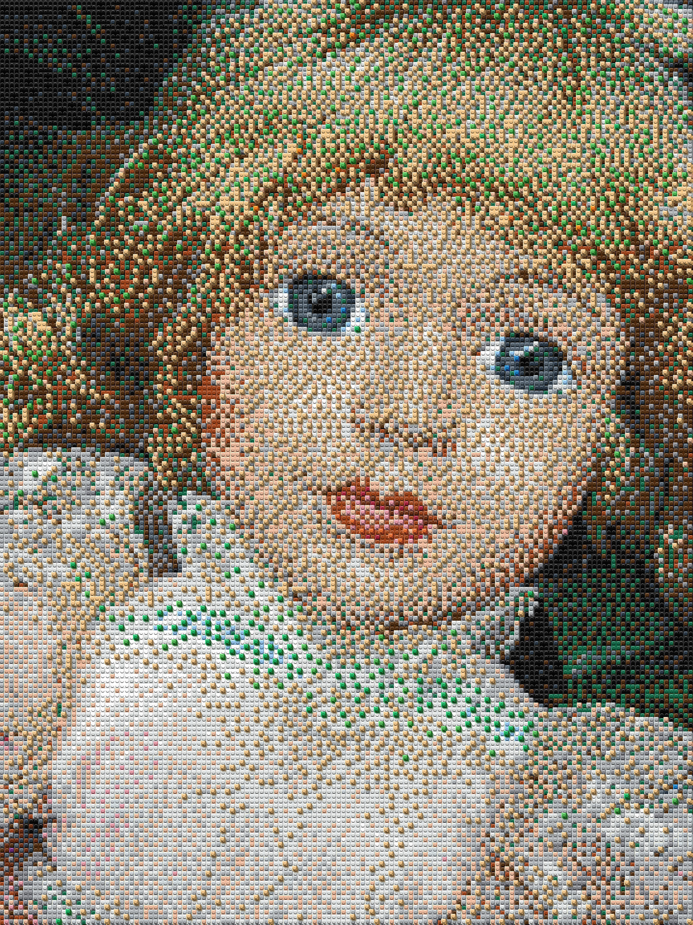

I just wish Pic2brick would allow you to re-open the file for additional tweaks. They've not updated the program in a long time now either. Maybe I asketh for too mucheth. lol
 Post subject: Re: Online Ministeck.
PostPosted: Fri Jan 09, 2015 3:21 pm  (#25)
Posts: 12850
OK; had a brain fart and figured out a way to get the selections (still convoluted, but doable). Now I can do a better job at creating 3D Legos but now the lego pieces won't a have the seams that the original tute (don't ask me the link; way too lazy to find it) had (i.e., you can have distinct pieces like right angles, multiple lenth straights, vertical and horizontal, etc.). :)
