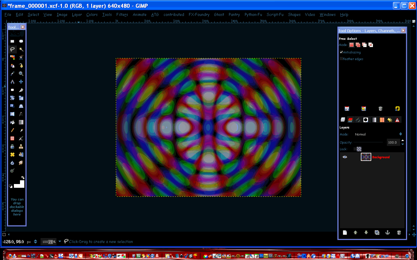

Good morning
ok,on the barber pole animation
as soon as i try to apply video/frames modify,i get Gimp messages:plug in diffraction iterator not found.and then too many errors.
I tried to ignore the messages,but when i animate all i get is the striped layer turning into a cylinder then back to a flat striped image.
Any idea why?
 Post subject: Re: oops,forgot to add a title
PostPosted: Thu Oct 13, 2011 8:35 am  (#24)
well the message says that a needed file was not found
I could not imagine how the file could get lost, it seems more probable that your GAP version didn't match your Gimp version
About the file there are 2 possibility or is called something as Diffration_iter.exe or is included in GAP, i mean included in some of GAP binary.
Recreate the file is not easy

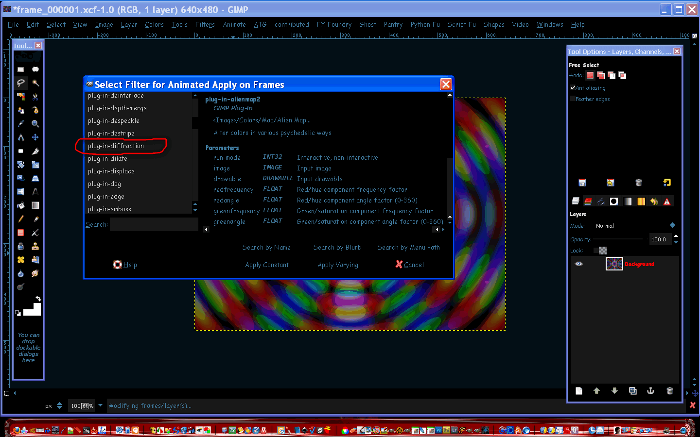

Ahh..thank Molly
Any idea why?
Are you sure to have chose the right filter to call from Frame Modify dialog?
Because the message says you wanted to use the diffraction filter, not the Map Object filter as required from the Tut

You probably need to re-install the diffraction pattern plug-in file, or check for conflicting duplicate DLL files.
I do not remember which DLL files come with GAP's install however.
Does the error occur when you click the Frames Modify menu link, or after the dialog for modify pops up and you click (apply varying)?
If the plug-in - diffraction pattern is in the list in that selection dialog (apply animation on frames) that means the plugin is installed.But it could still be faulty.
When you run Frames Modify it will auto rename the image as an xcf file, if it isn't already named.
After it is named you need to save it before the modify will work.Or it will return an error "file not found"
I ran the diffraction with frames modify on my XP with Gimp-2.6.11 on 1 frame and it worked fine.

The errors I get are before is as soon as I open video/frame modify
That sounds like it tried to enter the diffraction plug-in in the list and couldn't find it.
I would re-download that plug-in.I am not sure if that is a default Gimp plug-in?
If it is a plug-in Gimp comes with PC has an online folder of all the 2.6 default plug-ins at Deviant Art site.
You can get them here. - http://photocomix-resources.deviantart. ... -100575270
There is also this one at the registry
http://registry.gimp.org/node/173
<-- out dated - Gimp comes with one installed at Filters/Render/Patterns/Diffraction Patterns
