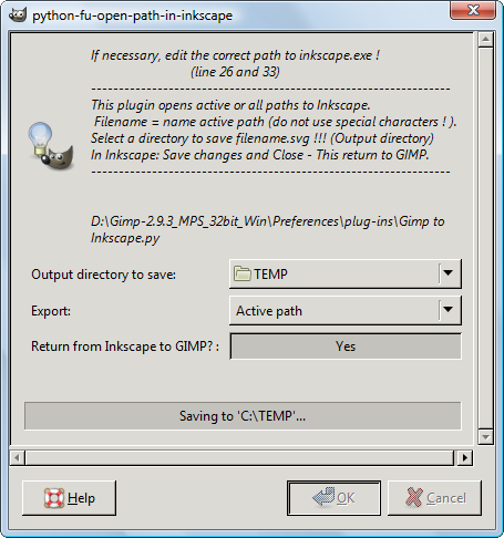

My two cents on path ...
Edit (17-03-206): newer version in the post (# 31)

MareroQ i get this trace back error running the filter.

Sorry for the late reply. For some reason I am not getting reply notifications anymore and need to investigate.
I thought this thread had died on the vine but luckily decided to look in on it anyway.
TYVM MareroQ!
This works perfectly for my needs.
I tried it and got errors similar to Rod, but checked the script and saw the default path was for windows and not linux.
After that the only trouble I had is if you don't select a save directory (the default None), I got the exact error as Rod.
Once I fixed the first two stumbling blocks I was golden!
This is works great for me, but it would be cool if you could hard code a default "temp" directory since it seems to require a valid path and None is not a valid choice.
This would be a great default choice if you don't intend to keep the svg and just wanted to edit the path in Inkscape and return to gimp.
(If you try with none and get the error, you can't then select a path again as the "OK" button is greyed out. You have to close the dialog and try again.)
Regardless. I can't thank you enough!!

 Post subject: Re: Script Mod Requests
PostPosted: Sun Feb 28, 2016 1:48 pm  (#13)
Odinbc - add export active path
Rod - You have selected the directory before starting: "Select a directory to save filename.svg" ?
Akovia - add katalog C:/TEMP (for Linuksand so You have to change ... /home/TEMP or wherever You want)
Gimp to Inkscape V-0.2.7z [1.39 KiB]
Downloaded 114 times

Rod and MareroQ: the following post http://gimpchat.com/viewtopic.php?p=177842#p177842 seems to explain, at least for GIMP-2.8 on 'Windows', the problem Rod had.
Also a suggestion for version-0.2 line 54 at the end, replace ...''C:/TEMP'' by ...''/TEMP'' this will be more 'Linux' friendly while acceptable for 'Windows'. (But for 'Linux' you have to change also, the lines with the ..."\\"...)

Hi Robert.
Thanks for info.
In next weekend - try to apply to Your advice.
I plan to add also:
- point to the directory where Inkscape (select directory - not edit plugin);
- delete the filename.svg if it is open when you return to Gimp (choice: yes or no).
For me, it will look for solution - a You are the Master of the programming - so can You finish (or quite changed in order to optimize) this plugin for Akovia and for others (and me)?
Just a heads up on setting /TEMP on linux.
When I set my temp dir on Arch Linux, I set it to /tmp, which is the default tmp folder. (was the same when I ran ubuntu and xubuntu as well.)
Problem is that the plugin failed with "Permission Denied", since that is a root folder. I'm sure I could change some permissions to make it work, but I don't think it will "work out of the box" using /tmp, or /TEMP. Especially since /TEMP doesn't already exist.
Anyway, I ended up setting my default home directory trash folder instead.
/home/akovia/.local/share/Trash/
So I doubt there would be an easy way to cover both OS's
If anything to make it easier for the uninitiated would be to have variables at the top of the script, but I doubt anyone using this would have too much trouble setting their paths.

Hi,
MareroQ:
I am not a master of programming (not easy for me) but like to go my own way.
Your plan for this plug-in appears sensible to me so I encourage you to persevere.
'os.sep' is the sub-folder separator for both Linux (/) and Windows (\) in Python.
akovia:
My suggestion to 'MareroQ' was not base on existence of those folders in the respective OS
but to have the usage of 'PF_DIRNAME', with minimal change, for selecting the folder that you wish.
The suggestion 'os.getcwd()' is better for folders existence in both OS, but probably not your final choice.
After testing, it's right to replace the default by your choice (new default).
You adapted this to Arch Linux already so felicitation for this.
Have you shown your work to 'MareroQ'?
