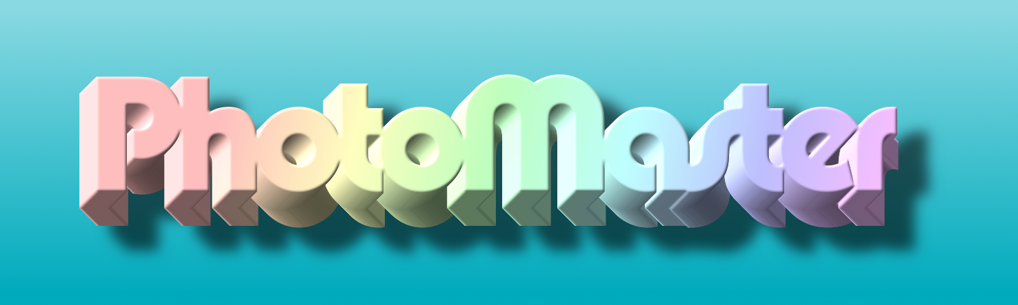

I have/had this script and spent hours trying to find it here on GC with no luck. Hopefully someone will be able to identify it for me? Any help would be appreciated. It's a 3D text script that creates this type of logo:

The name of the script is '3D Bevel'

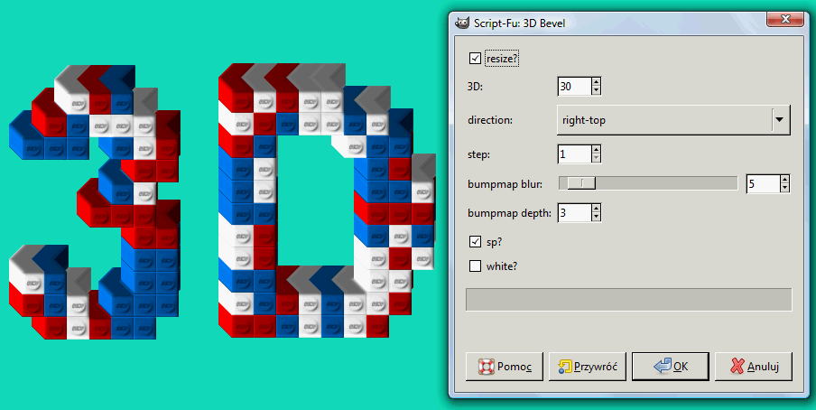

In Menu:
File/Create/Logos/3D Bevel...
Filters/Alpha to Logo/3D Bevel...
2028_mhbevel3d.zip [3.01 KiB]

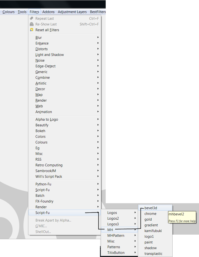

PhotoMaster, I don't know if this one is the one you are looking for. But I have this under filters where I have drawn a black line. I hope this can helps you. :)

Thank You All!!
Issabella hit it on the head! It was there and I just couldn't find it!

MareroQ, Is this a Lego font you're using??
My Sigs = My Photos
 Post subject: Re: What script is this??
PostPosted: Fri Jun 10, 2016 8:25 am  (#20)
Hi PhotoMaster.
I use custom blocks (3 - created 16) + custom-font-composition Trandoductin (before using the 3D Extrusion).
