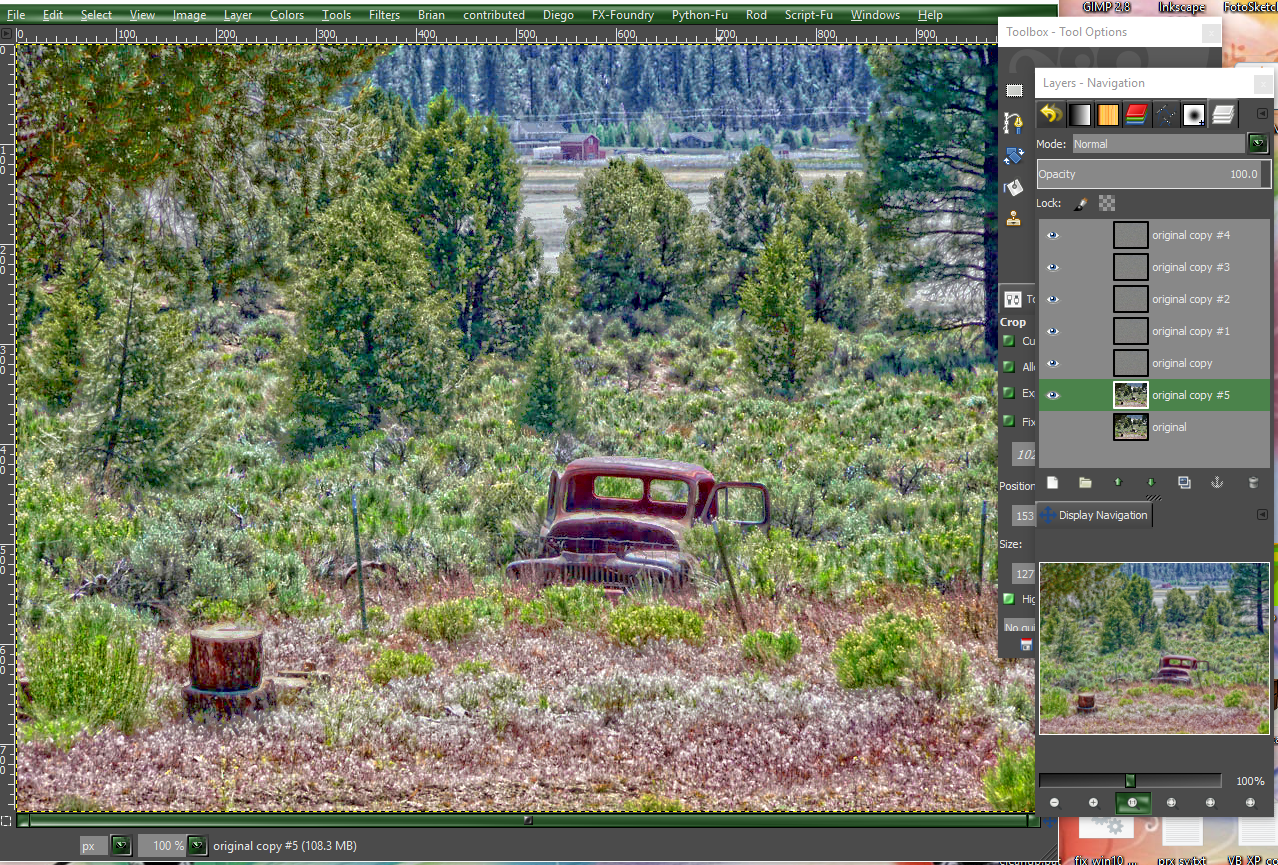

ref: http://www.fontplay.com/freephotos/twel ... 108-01.jpg

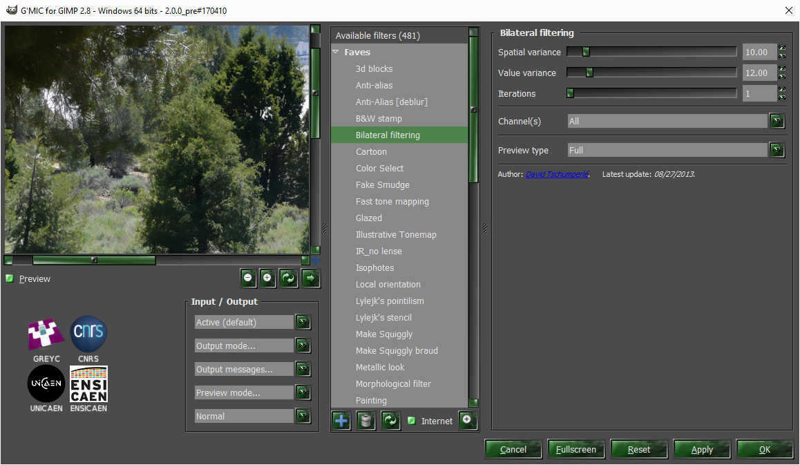

First step is to create the convolution layer. Just dup a few times and hide base layer. Then top layer set to Hue and center layer set to Grain extract. Run G'MIC's Bilateral smoothing preset and merge visible. Screen shots below.

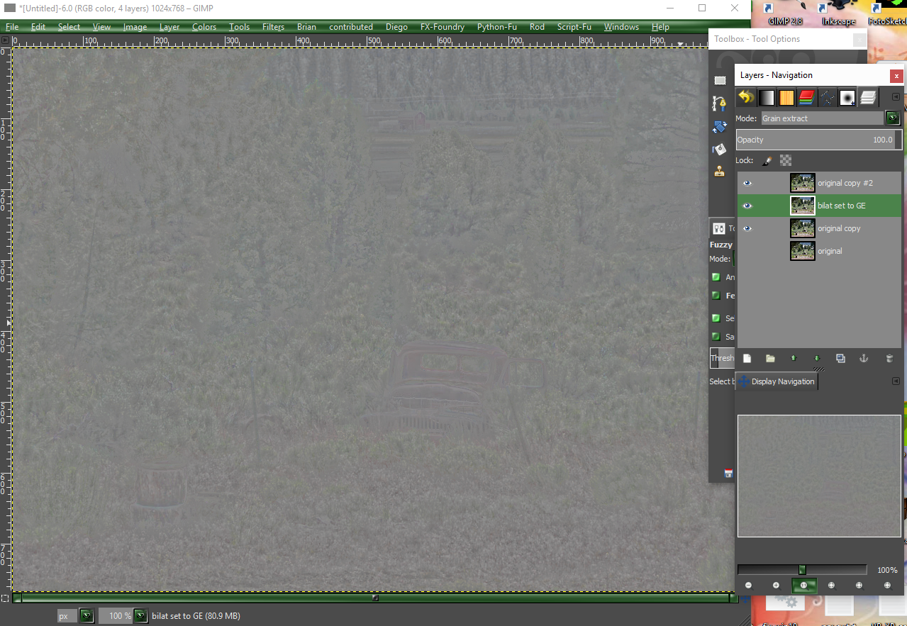

Now use the convolution layer a few times; all convolution layers set to Grain Extract except the bottom one which needs to be set to Value and adjust opacity to taste.

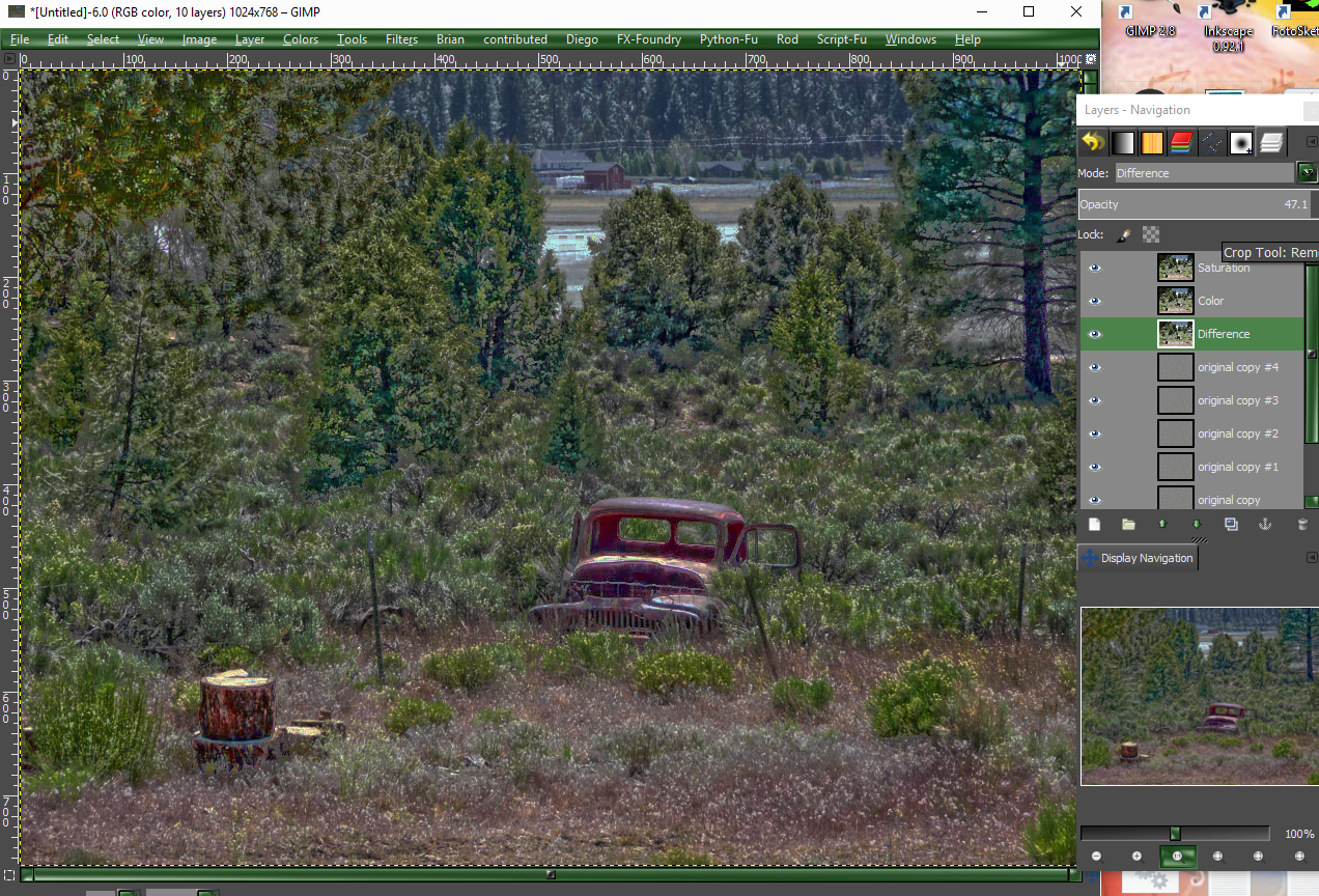

For a more surreal look. Copy the base layer and move all the away above the convolution layers and set the lowest one to Difference, the one above that to Color and the one above that to Saturation and adjust levels to taste. Again these are hints. Can choose to auto-level and many other things to get a result that's more to you liking. Unfortunately those steps aren't rote so I don't believe you can automate such a flow (not to mention artifacts; see lid of truck for instance and the line that occurs between light and shadow). Those artifacts require manual cleanup (what a pain). I didn't do so since this is not a tut but a guide. :)
