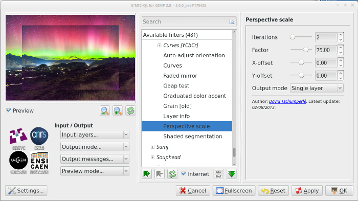

I compiled the G'MIC-qt for GIMP 2.9 in QT 5.7.1 (for Windows 32 bit XP and Vista).
For those willing to test - download:
https://www.dropbox.com/s/fhrevh2a1a7jwgf/gmic-gimp-2.9-qt-2.0.0_pre-win32.zip?dl=0 (28 227 312 bit)
There was one problem - translations not works (in no language).
Edit: 07-05-2017 new version in post 196.
