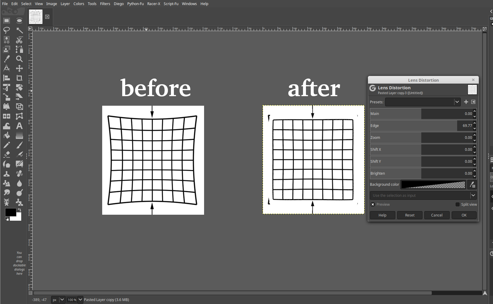

You can try "Lens Distortion" in the Filters>Distort menu.

Not sure the lens distortion is an adequate transform, we would need something that "unrolls" the picture:

It worked (some) but better with the distortion with curved lines. Thank you for the tips.
