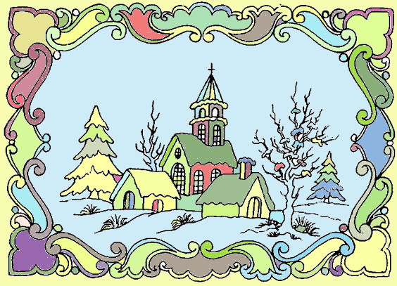

Dear friend Diego, your script works very well but could I ask you that the remove option black line was optional by the user? I like the black definitory line in some items. Thanks a lot.
 Post subject: Re: Multi-Fill Script Help
PostPosted: Fri Oct 11, 2019 4:23 am  (#162)
Issabella, it is optional.
PostPosted: Fri Oct 11, 2019 5:44 am  (#163)
Anyhow, I made an addition which preserves also the filled with borders, when the option "remove grid" is selected.
So you get 2 layers, on top the one without the black borders, the other one below with the black borders.
DIEGO_RENDER_Filling.7z [2.34 KiB]
Downloaded 117 times
Could you try?
