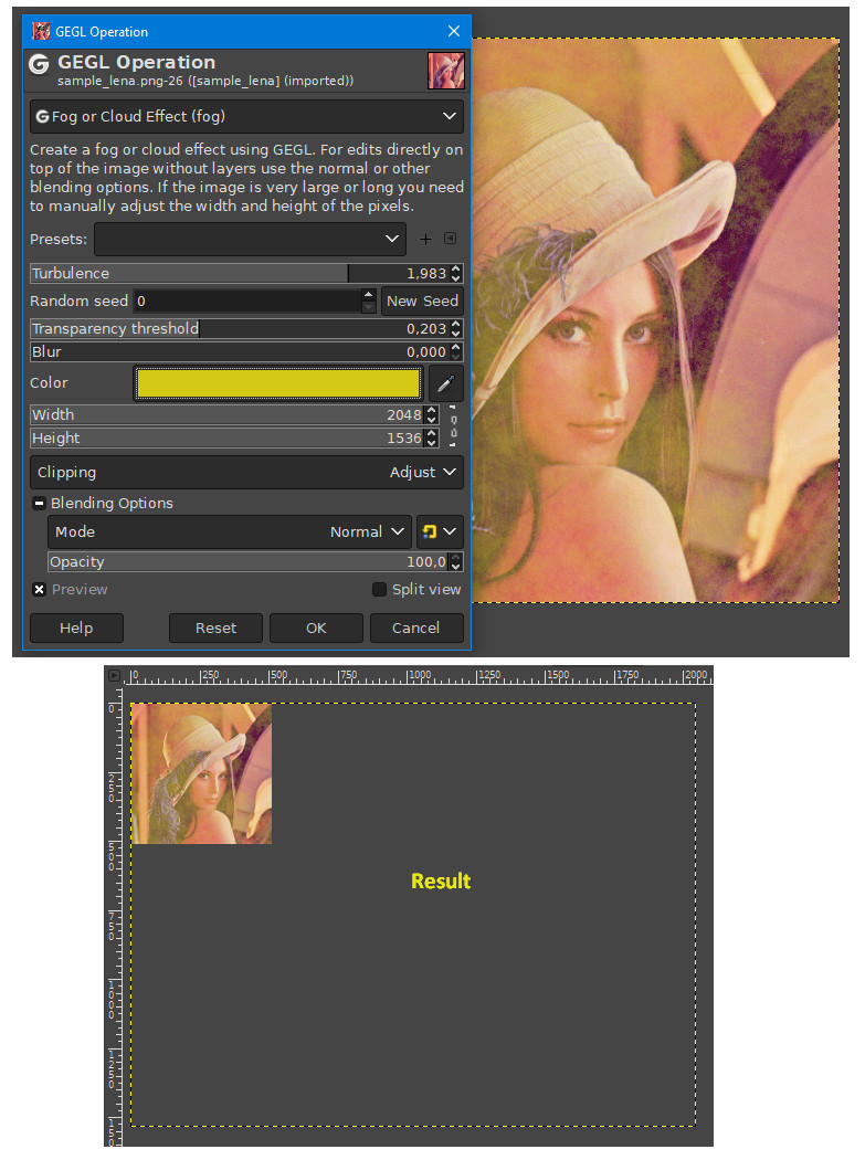

..."If the image is very large or long you need to manually adjust the width and height of the pixels." ...
Could Gegl not get the image size?
Also a bit of an inconvenience with images smaller than 2048x1536:

Unfortunately, I had to make a tough decision to make it work on large vertical images and users have to manually input pixel size if the image is over 2048x1536. If I did not do this then the effect would not work on large vertical images.

Just hit layer to image size after applying fog. I don't seem to have that problem though

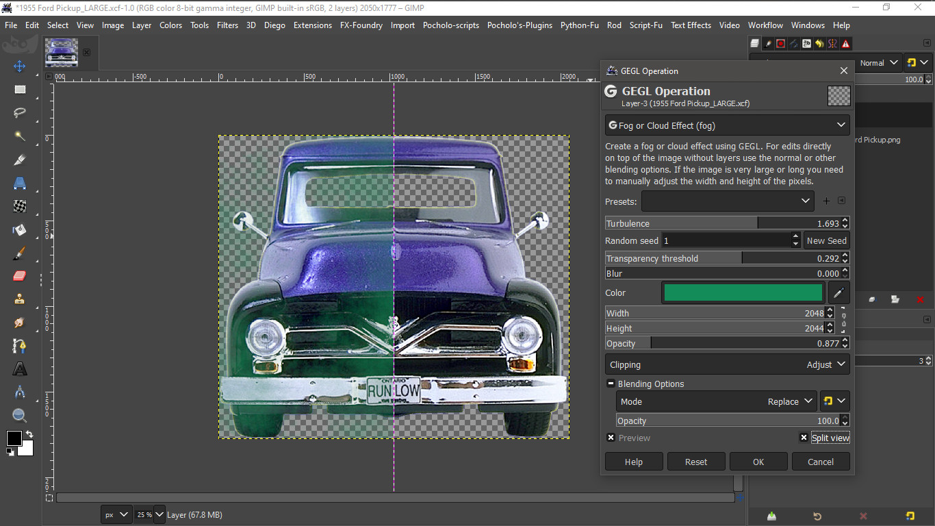

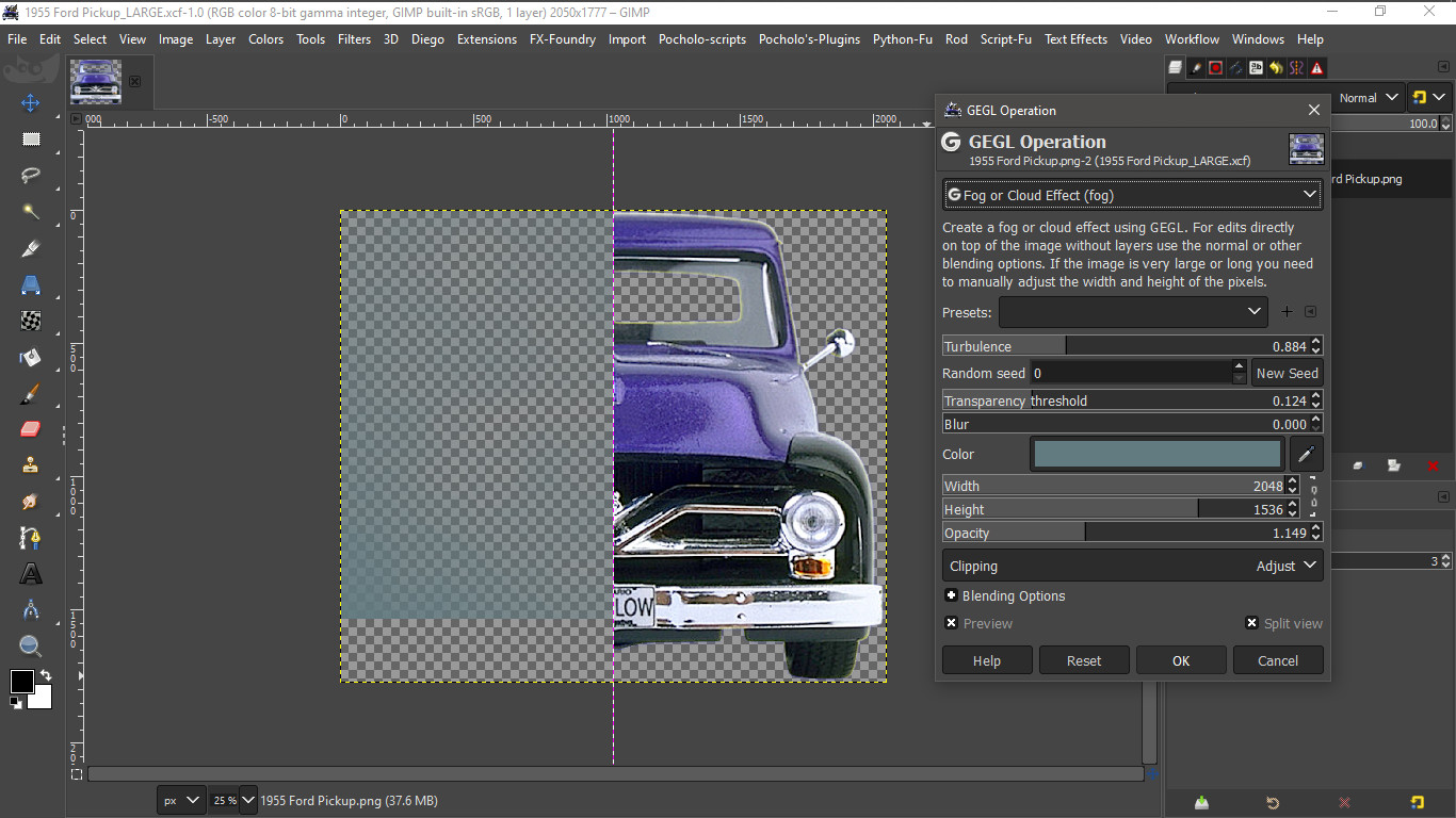

PostPosted: Fri Jul 15, 2022 8:10 pm  (#13)
Posts: 16139
Windows 10 64 bit
image size - 2000 x 1770
Maybe i am not using it correctly?
It did indeed allow me to resize by clicking the height value but my results were just a fog image and no transparency.

Am i supposed to create a new layer and set the mode to lighten only?
 Post subject: Re: GEGL Fog Effect
PostPosted: Fri Jul 15, 2022 8:21 pm  (#15)
Posts: 16139
Figured it out! :)
Sorry didn't see the blending modes button.

PostPosted: Tue Aug 23, 2022 1:21 am  (#17)
Posts: 16139
contrast_ wrote:
This filter now works on single layers regardless if you use the normal blend mode or not. I did not intentionally do this originally but I choose not to fix it as a way to encourage people to use layers. Now you don't need to use layers or the normal blend mode.
I can do the same to GEGL action lines
Thx contrast. I am waiting for Gimp to load so i can test the Windows 64 bit dll file. Then i'll add the zip attachment to THIS post.
Pocholo if i do you should remove your compiled Windows version so as not to confuse others who skip thru the thread.
Works Great! :bigthup
DLL file attached.
Gegl_fog.7z [29.68 KiB]
Downloaded 67 times
Just unzip to AppData/local/gegl-4.0/plugins folder. THIS WILL REPLACE THE OLD Gegl_fog FOLDER!
So when it asks you to replace allow it to.
