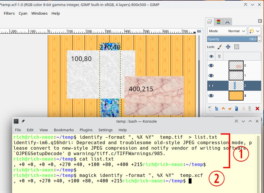

So I have this big image (2000x1000px) with hundreds of smaller layers. I need to get the offsets automatically, somehow.
When I rightclick on the "Layer Attributes" I can see the offset values (Offset X & Offset Y). From here I could get the values, but I really don't want to do this manually hundred times. :(
Is it possible to run some script and save that data to either the layername or a txt-file. The format doesn't really matter.

You could use ImageMagick (IM), Using linux ? then probably still on IM6. Export your layered image to a tif file, then to list the offsets in a text file. (1)
identify -format ", %X %Y"  temp.tif > list.txt
If you get the IM7 linux magick appimage from https://imagemagick.org/script/download.php then you can use Gimp xcf format similar syntax. (2)

Thanks! I can work with this. Just need to make some scripts.
