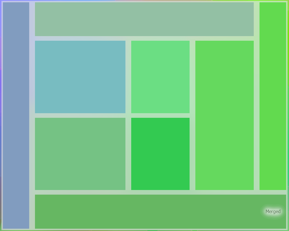

PostPosted: Wed Dec 13, 2023 7:02 pm  (#12)
Joined: Jul 04, 2019
Posts: 282
Location: Lake Havasu City, Arizona, USA
In this Roller 4 demo I made this as a proof of repair of the Table/Cell/Type/Per Cell option as it was broken Roller 4.10. This preset has a Table model with its Per Cell option selected and its cells merged in the shape presented in the demo image. The Roller 4.11 download can be found in the first post of this thread.
Table/Cell/Plaque/Average Color is used to make the colored rectangles.
File comment: Has a text how-to file and a Roller preset file.
Demo.zip [4.81 KiB]
Downloaded 237 times
Charles
