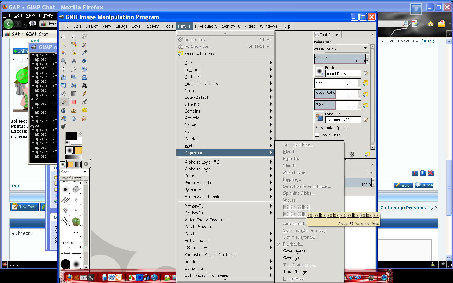

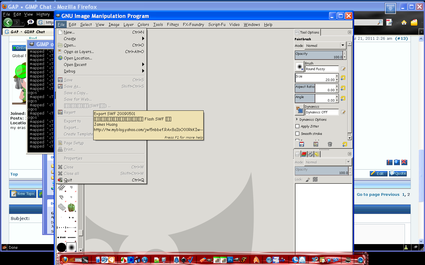

Looks good except i will need to do some script editing to see what these menus have to say. ;)
I like how you placed your name in the export SWF menu :lol
Here are some screen shots.
I like how you sub divided the Filters menu for catagories...nicely done! :bigthup

sorry
these are just translated it to chinese language, you may delete or replace with english version
settings\plug-ins\calendar-en.py Filters/Python-Fu/XXXXXXXX
settings\scripts\sg-calendar.scm Filters/Render/XXXXXXXX
settings\scripts\fp-kaleidoscope-anim.scm Filters/Animation/XXXXXX
settings\scripts\CarTOONize.scm Filters/Artistic/XXXXX
and these files are what I wrote, if you no need, just delete these files
settings\plug-ins\ExportSWF.py File -> XXXXXX(SWFXX)
Export SWF English version
settings\plug-ins\VerticalText.py Filters/Python-Fu/XXXXX
vertical text
settings\scripts\strdflash.scm Filters/Script-Fu/Logos/XXXX
settings\scripts\strflash.scm Filters/Script-Fu/Logos/XXXX
settings\scripts\idPhoto.scm Script-Fu/Photo/XXXXXXX
use rectangle selecti tool define a region
then
settings\scripts\layers-delete.scm FX-Foundry/Multi-Layer Tools/XXXXXX
start layer (x) and delete layer every (y) layer
settings\scripts\strBlinking.scm Filters/Script-Fu/Logos/XXXXXXX
Filters/Animation/XXXXXXX
English version
then
English version
