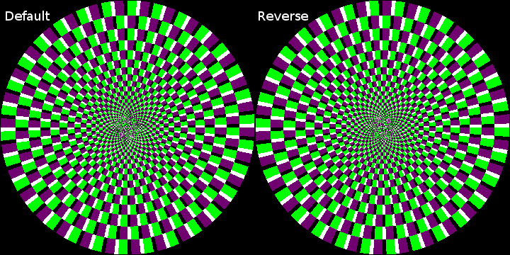

I tried an experiment. Rather than try a bunch of colors, I wanted to see what reverse colors might show using at least one default. The first example on the left, default r1 and r2 and on the right r1 and r2 default values reversed. The second example is as noted. My eyes are not the best. I see movement in the first example and maybe a bit in the second example.
I picked the color in the second example from the Solarized palette because the color should show equally well on a black or white background.

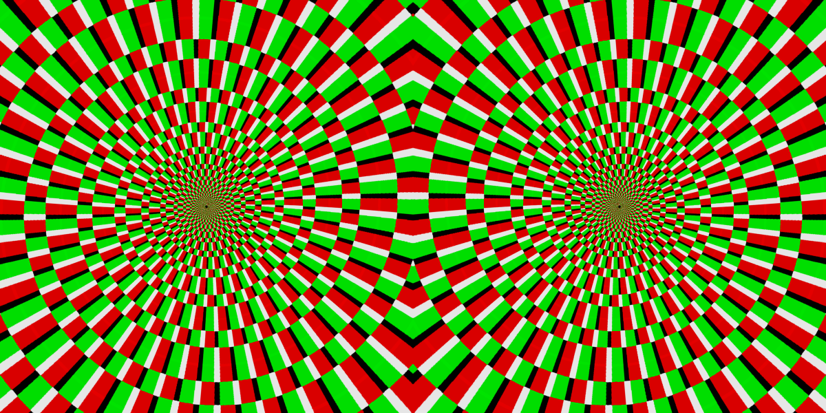

Extremely cool indeed. Added my own "spin" to the rendered result. Thanks a heap. :)
