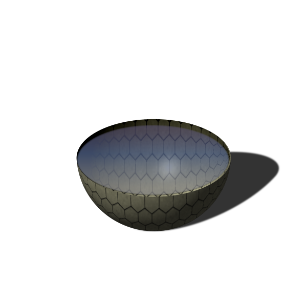

Nice one O! :bigthup
I messed up and left the light src on and so i filled it with water and tried to make it look like the water had a reflection. Hmmm could you call this the "Gator Bowl" :rofl

Molly, that's very nice. Clever using the denim and putting Wilber in the mix. :hi5
:lol @ Rod - gator bowl. :hehe
