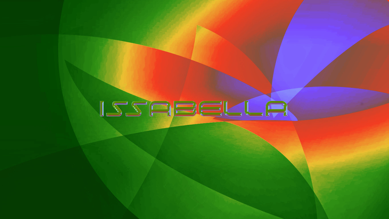

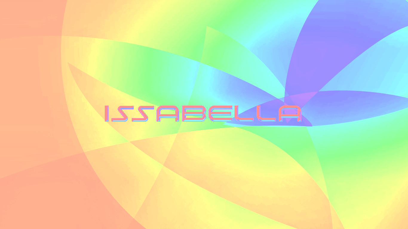

Posts: 14816
once you have one, click on Colours/Map/Gradient map
and you will have nice outcomes easily...

enjoy the extra benefits of this nice tutorial
