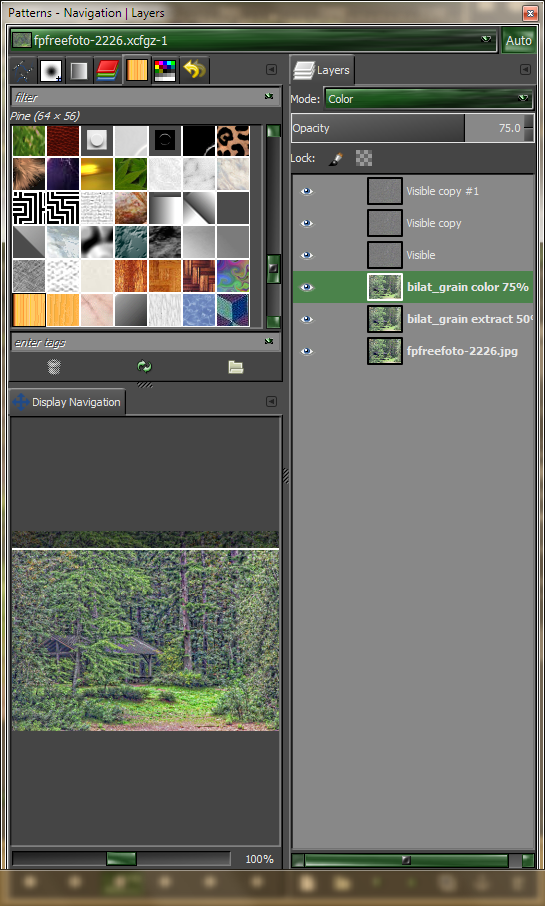

OK; just finalizing the tut; any additional tweaks are up to you (I already mentioned suggestions). I don't document nuance. lol
Result:

what are those grey visible layers?
 Post subject: Re: Fake HDR.
PostPosted: Thu May 15, 2014 8:01 pm  (#28)
Posts: 12854
Dup, bilateral (g'mic) filter result set to Grain Extract 2-ton. The gray like layer is called a convolution layer (thing Highpass filter). Set to Grain merge, it amplifies the change each time you duplicate the layer. :)

PostPosted: Thu May 15, 2014 8:09 pm  (#29)
thanks for clearing that up…makes sense now!
