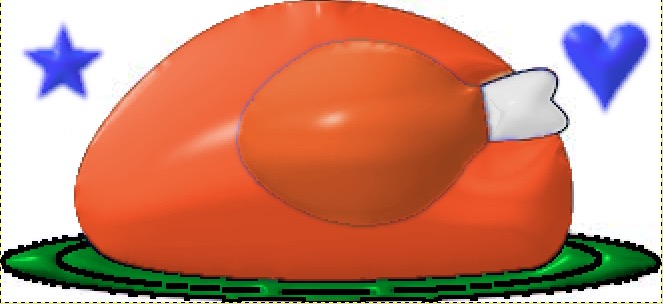

PostPosted: Wed Nov 19, 2014 1:35 pm  (#22)
I tried this with some clip art, and it's easier than using a photo. The turkey came out as expected but not sure why the heart and star are blurry. They are brushes stamped on their own layer and then I used the same brl as I did on the clip art part. Any clue as to why they blurred? The brushes do not look blurred before the filter.

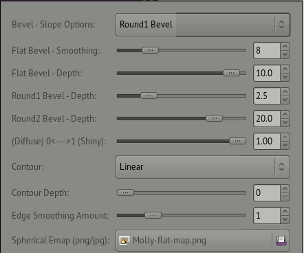

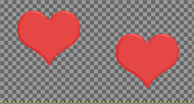

I made my hearts on a transparent layer, alpha to selection > shrink 2 or 3 run the script with these settings.
round bevel2 > Round bevel depth 2.5
After you run the BRL, right click on your BR logo copy, click on the eye and alpha to selection,
Use your color picker to select the red you used for the heart and fill that layer. You will notice sharper edges after you do that. You can merge the two or leave them, doesn't matter.
Then your hearts
If you want smoother edges on your turkey, do the same thing, select and shrink 3 pixels or more, whatever works best.

PostPosted: Wed Nov 19, 2014 3:03 pm  (#24)
Aha, I bet the brush edges were blurred so they wouldn't have jaggies. Next time I will shrink the selection. I still want to try to get better at using this process on photos.
2-ton, try doing one exactly like I showed you above and your will see the difference. You can edit>undo as many times as you want so keep changing the depth or any of the other settings until you are happy with it. Some things work better on larger images, some don't, It is all trial and error.

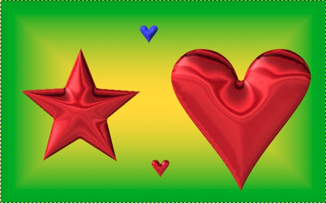

PostPosted: Wed Nov 19, 2014 4:54 pm  (#28)
followed your instructions step by step...success, thanks Molly! This works well for single items, but I can see myself getting all mixed up when trying to do a somewhat complicated picture. I now see why the default is always blue...it's the major color on the default gradient, and that is what is used if I don't pick an e-map. And I still would love to see examples of what the sliders do without messing around for hours. I am impatient and lazy.
